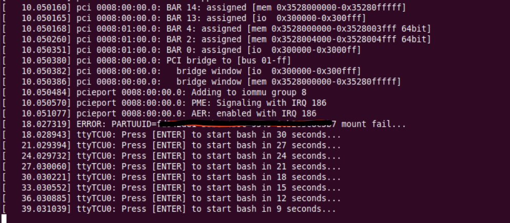

I have a Jetson Orin NX 16GB device. I’ve flashed it. After that when I try to open orin, this comes up while boot,
[   18.082390] Finding OTA work dir on external storage devi /dcesev/sd?1 does not exist
Checking whether device /dev/nvme?n1p1 exist
Looking for OTA work directory on the device(s): /dev/nvme0n1p1
[   18.101518] mount /dev/nvme0n1p1 /mnt
[   18.116597] EXT4-fs (nvme0n1p1): recovery complete
[   18.116821] EXT4-fs (nvme0n1p1): mounted filesystem with ordered data mode. Opts: (null). Quota mode: none.
[   18.118641] is_boot_only_partition /mnt
[   18.127039] OTA work directory /mnt/ota_work is not found on /dev/nvme0n1p1
mount: /mnt: special device /dev/mmcblk0 does not exist.
[   18.134000] Finding OTA work dir on internal storage device
[   18.135230] mount h: /dev/mcanmcb set term /ml proc
                                                      ess gr 18oup1] 1):Fai Inrop to mote ioctl for de /dviceblk0 on the h:t
no [  ntr.13ol in 931thi7] s sledl run "mount_ota_work_partitbash-5.1# mmcblk0 /mnt"
[   18.140551] OTA work directory is not found on internal and external storage devices
bash-5.1#
bash-5.1#
bash-5.1#
Even though the NVMe is inserted to Orin device, it cannot mount and opens in bash. I cannot boot the device normally. How can I solve this?

I did what you said, I choose normal for OS chain A status, save and exit. But after reboot this problem comes up. Still can’t boot normal I guess. After reboot, OS Chain Status automatically changes to Unbootable again.
[   16.658053]  nvme0n1: p1 p2 p3 p4 p5 p6 p7 p8 p9 p10 p11 p12 p13 p14 p15

Currently, I am encountering different errors. After some reboots, I get this error. Other times, the issue with OTA appears.
Has this NVMe disk ever worked before?
Yes, it was working. I was using it on Xavier NX before and there were no problems with the NVME
Did you re-flash it before putting it on an Orin NX board?
Sure, of course. First, I have flashed with the Image specific to the Orin and then connected it.
Can you please put the flashing log here?
