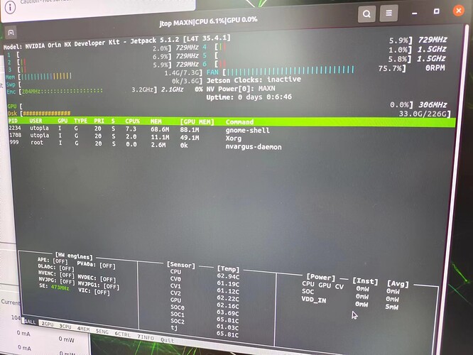

In the process of use, VDD_IN, VDD_CPU_GPU_CV, VDD_SOC in the power GUI found that the display is not normal, and it is the same in jtop.
The display in the jetson xavier nx board is normal,The situation is shown in the following figure:

A custom board is used, and the value of the parameter VDD_IN in the power GUI is not correct
The power GUI shows that VDD_IN is 0mW, which is not correct

Would VDD_IN still show 0V after you reboot the board?
After the restart, VDD_IN is still 0mW

It seems the issue is specific to your custom carrier board.

In your result, since the reading from jtop and PowerGUI are the same, we don’t think the issue is caused from the tool itself.

I would like to ask how the value of VDD_IN is calculated, is there a related script?
Please study the reference schematic and PCB assembly files of the P3768_A04 board package in DLC to get the point to measure the VDD_IN.
Jetson Orin Nano Developer Kit Carrier Board Reference Design Files
VDD_IN is the power rail from carrier board. It is 0v on your board. If you are using custom carrier board, you should check with the vendor for how to measure the VDD_IN and why it is 0v.
