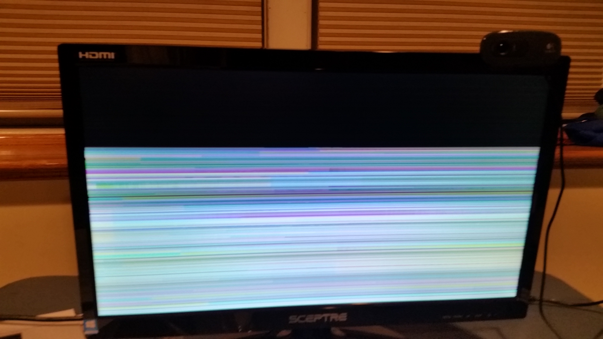

I downloaded and installed the latest Jetpack 2.3 and I was able to get my Logitech USB camera to work as a v4l2 camera at index 0. I tried to run the nvgst_camera_capture sample program and the window displays a very streaky display that displays data but definitely not correct. Has anyone out there been able to get the onboard camera to be properly framegrabbed and displayed? I haven’t been able to get it to work either with this jetpack or the prior one. I’m beginning to wonder if it works at all.

ok, so I just tried nvgst_sample_player --source=device:///nvcamera?index=0 and I see a screen of green horizontal streaks.
I also typed in carefully the gst-launch-1.0 nvcamerasrc fpsRange=“30.0 30.0” ! ‘video/x-raw(memory:NVMM), width=(int)1920,height=(int)1080, format=(string)I420,framerate=(fraction)30/1’ ! nvtee ! nvvidconv flip-method=2! ‘video/x-raw(memory:NVMM),format=(string)I420’ ! nvoverlaysink -e
command and it gave me a full light green screen.

I just ran another test
nvgstcapture-1.0 --camsrc=0 ( this was fine as it was the USB camera )
nvgstcapture-1.0 --camera=1 ( this was not fine as it was the CSI camera , scrambled output )
nvgstcapture-1.0 --camera=2 ( this was the test pattern and it was fine as well )
So another test conforming the CSI isn’t working.
Could you check the kernel message to see if the sensor driver was probe after boot. If not your camera board may not connect to TX1 as well or have problem.

I ran the dmesg | grep ov5693 command and I get the following:
4.466045] [OV5693]: probing v4l2 sensor.
[ 4.466324] ov5693 6-0036: Failed to allocate eeprom reg map: -22
[ 9.869042] vi vi: parsing node /host1x/i2c@546c0000/ov5693_c@36
[ 9.869049] vi vi: handling endpoint /host1x/i2c@546c0000/ov5693_c@36/ports/port@0/endpoint
[ 9.869071] vi vi: subdev ov5693 6-0036 bound
[ 9.869091] vi vi: creating links for entity ov5693 6-0036
[ 9.869097] vi vi: processing endpoint /host1x/i2c@546c0000/ov5693_c@36/ports/port@0/endpoint
[ 9.869119] vi vi: skipping channel port /host1x/i2c@546c0000/ov5693_c@36:0
[ 9.869160] vi vi: creating ov5693 6-0036:0 → vi-output-2:0 link
when I run the v4l2-ctl command I get the following:
bash: v4l2-ctl: command not found
what do you see from this?
Your log shows the sensor driver ov5693 probing well. You can install the vl4-utils by sudo apt-get install v4l-utils to get v4l2-ctl. Could you also check the kernel message after you get the green screen. If there’s a lot of syncpt timeout that that may cause by the HW issue try to reconnect the camera board again and please follow #10 to report it.

There are two screw to lock the camera board you need release them first.
External Media
I reseated the camera but didn’t change anything
Runnine v4l2-ctl --list-devices
Shows
UVC Camera (046d:0825) (usb-tegra-ehci.0-1):
/dev/video
So now video doesn’t show up anymore .
Gone from bad to worse.
/dev/video1 showed up before but now it’s gone.
The Camera Is Seated We’ll and screwed in tight
Can I use the RMA procedure and send just the camera back for replacement?
