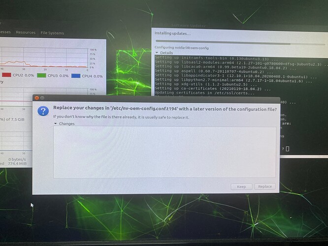

I am currently using a Jetson TX2 with Orbitty carrier board and having an issue as shown in the below.
When I flashed the TX2, it works fine at the beginning but it started to show up the following messages and never go into normal boot mode again (it happens when I update and upgrade the ubuntu).
I have tried to using Jetpack 4.3 through 4.5 with Ubuntu 18.04 (does not want to upgrade to 20.04 due to personal research purpose).

This error log is not related to your problem. Your issue is the desktop fails to launch.
Not sure why this happened. Could you use ctrl+alt+f2 to switch the console over the monitor, and then dump /var/log/Xorg.0.log ?
Also, are you sure this is TX2 but not TX2i/TX2-4GB board?

Firstly, yes, I am using Tx2 (8GB).
The solution of the above problem seems that I should not click the “Replace” button when the pop up message “Replace your changes in ‘/etc/nv-oem-config.conf.t194’ with a later version of the configuration file?” shows up as shown in the attached picture.
According to the google search, the nv-oem-config.conf.t194 is for the Xavier platform and so I should not replace it since I am using TX2 platform.
I hope this helps someone in the future…
Edit: The problem is not solved. Same problem appears again even if I do not click the "Replace” button.
Can you share me how is your result of
ls -al /etc/nv-oem-config*
I am wondering why there is t194 config. But since your jetpack release is not the latest one, maybe this is already resolved on jp4.6.
Of course. Here’s the output of “ls -al /etc/nv-oem-config*”.
-rw-r–r-- 1 root root 1649 10월 27 2020 /etc/nv-oem-config.conf.t194.dpkg-dist
What is your current jetpack release on this board?
It’s JETPACK 4.4.
It is weird to see those files.
Is there anything like below?
ls nv-oem-config.conf*
nv-oem-config.conf.t186 nv-oem-config.conf.t194

Need to inform you that if this issue is due to some special setting from ConnectTech’s BSP, then maybe you should contact their support.
You can try to see if nv-oem-config.conf.t186 is under the rootfs/etc/ on your host machine with their BSP package.
