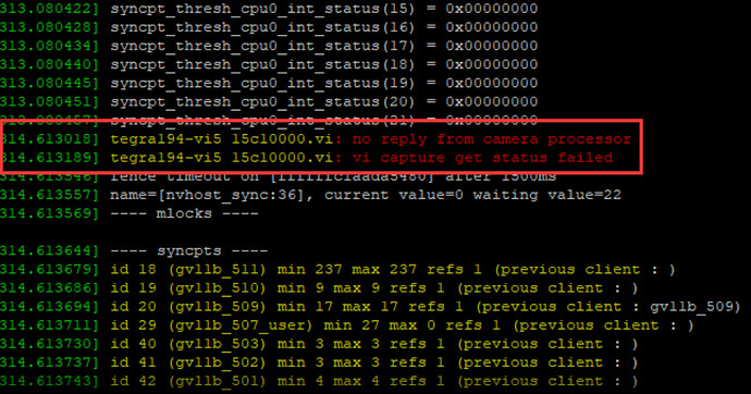

I have made my own Xavier NX carrier board, and want to use two iMX477 cameras on my customized board. So, I designed board to use CSI C and CSI G for the interface with camera.
CSI G port is working properly. Problem is CSI C.
When I install camera on CSI C, device can detect camera.
Here is dmesg:
tegra194-vi5 15c10000.vi: using default number of vi channels, 36
tegra194-vi5 15c10000.vi: initialized
tegra194-vi5 15c10000.vi: subdev imx477 31-001a bound
tegra194-vi5 15c10000.vi: subdev 15a00000.nvcsi–1 bound
But if I enter capturing command, it can’t generate images and it seems that the device lost the camera.
Entering snapshort capturing command:
Here is dmesg after I enter command:
tegra194-vi5 15c10000.vi: no reply from camera processor
tegra194-vi5 15c10000.vi: capture get status failed
I don’t know what’s the problem.

Did you verify by v4l2-ctl and confirm which sensor is working and which one can’t capture?
The sensor-id of nvarguscamerasrc may confuse for the port mapping for debugging.
