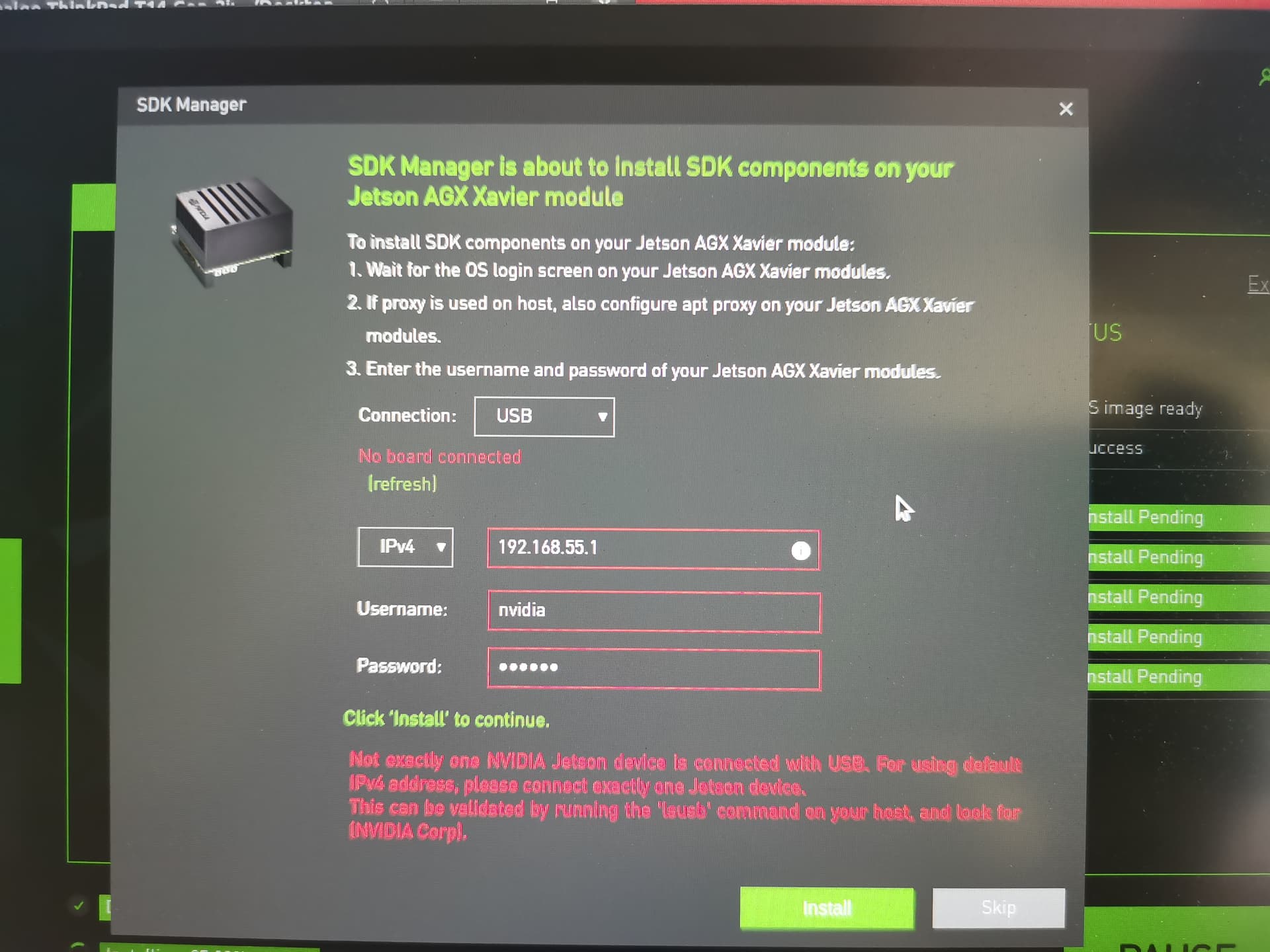

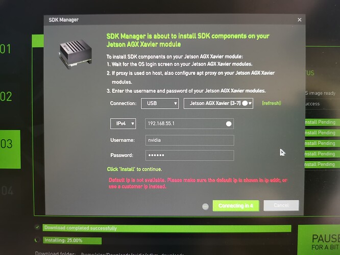

After I finish flash the OS to Jetson AGX Xavier, my SDK lost connection with Jetson AGX Xavier:
And I try to reset the Jetson AGX Xavier to connect with SDK, then the SDKmanager shows that default IP is not available:
Where should I find the correct IP address? I can’t see the information about IP on Jetson AGX Xavier.
Is your xavier already booting up into linux?
If so, do you have type C usb connected between your host and xavier? 192.168.55.1 is based on the usb connection.
It also requires your host to support ncm. If it does not support, then just use wired ethernet connection is also fine.

  2. I have connect the typeC USB and the ethernet, but when my xavier turn on, SDKmanager will shows “no board connected”.

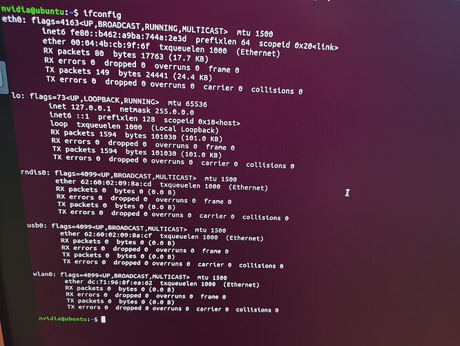

  3. I have use the wired ethernet connection, then Can you tell me how to get IP of xaiver?
ifconfig will show.

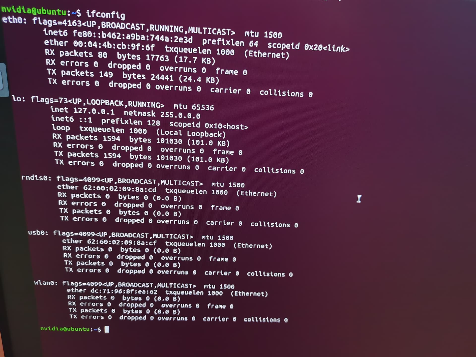

This is the infor of ifconfig on my xavier, but I can’t get the IP info:
This is kind of basic Linux. Not related to jetson.
If you don’t have IP, then check your network environment.

Then you need to manually set IP on both side if there is no dhcp server to assign IP.
As I said, this is not related to jetson. If you replace jetson to another linux computer, then the case will happen too.
After setting the IP address as you said, sdkmanager can connect to xaiver. Thank you very much for your patient guidance!
