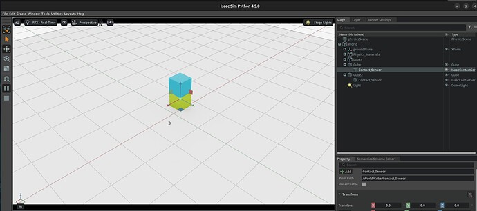

While trying to figure out how I can do simple collision checking in Isaac Sim or building upon Isaac Lab, I was exploring the ContactSensor class and followed the guide in the documentation. There, it is mentioned that the get_current_frame()method should return a dictionary with various entries. Among them: body0 and body1. However, in my test runs, these entries appear to be never created. I stepped with the debugger through the ContactSensor class and noticed that self._current_frame does not have contacts and thus, the body entries are never created. See lines 109 and following in contact_sensor.py:

I’ve tested this with a single and two cubes. Furthermore, I observed that the number_of_contacts value never exceeds 1 even though I would expect 2 for a cube that is between the ground plane and has another cube lying on top. From one of the screenshots attached you can see which values are actually set.
Am I missing something or is this a bug?

Hi @Zacryon thanks for bringing up this issue! I am able to replicate the issue. Let me reach out to the internal team.
Sorry for the delay but this should be fixed in Isaac sim 5.1.0
