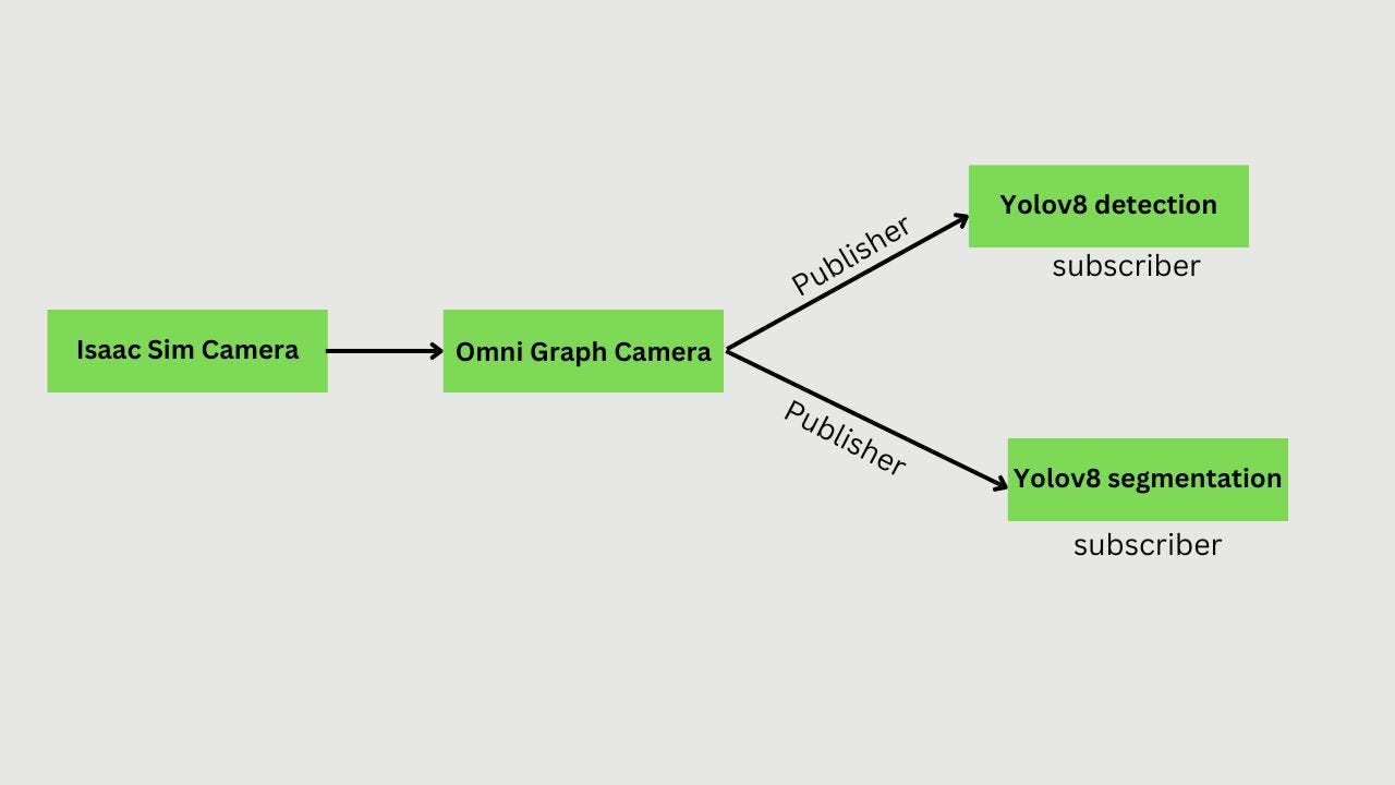

In the rapidly evolving world of robotics, simulation plays a pivotal role in accelerating development and testing. NVIDIA Isaac Sim is at the forefront of this revolution, offering a robust platform for simulating AI-powered robots in high-fidelity environments. Whether you’re working on autonomous navigation, manipulation, or perception, Isaac Sim provides a rich set of tools to create, test, and refine your robotic applications.
In this blog, we delve into integrating NVIDIA Isaac Sim with YOLOv8 for object detection and segmentation, focusing on a warehouse environment use case. We’ll explore how to set up Isaac Sim’s camera using Action Graph, process the camera feed with YOLOv8, and visualize the results using ROS2 tools like RViz and RQT.
 ![](https://global.discourse-cdn.com/nvidia/original/4X/3/d/6/3d6f1845d149337ddc74d527a3ab2272d5b4cbaa.jpeg)
### Setting Up the Isaac Sim Camera with Action Graph
Isaac Sim’s Action Graph is a versatile, node-based system that allows users to create complex behaviors and data pipelines without the need for extensive coding. The Action Graph can be used to control robot behavior, simulate sensor outputs, and in our case, publish camera images.
 ![](https://global.discourse-cdn.com/nvidia/original/4X/8/4/3/8435f5f7cbd02fca8175bb1d149536e3001a7324.jpeg)
**Steps to Configure the Camera Publisher:**
1. **Creating the Camera Node** :
- Start by launching Isaac Sim and setting up your simulation environment.
- Add a camera to your robot or a fixed position in the warehouse environment.
- Use the Action Graph to create a new node that captures the camera feed and publishes it as a ROS2 topic.
**2. Setting Up the Action Graph** :
- Within the Action Graph, link the camera node to a ROS2 Publisher node.
- Configure the publisher to stream images on a specific topic, such as `/warehouse_camera/image_raw`.
**3. Testing the Camera Feed** :
- Before proceeding, ensure that the camera is correctly publishing images by subscribing to the topic using a ROS2 tool like `rqt_image_view` or by echoing the topic to verify the data stream.

#### YOLOv8 Node Code Explanation
The provided Python code integrates the YOLOv8 model into a ROS2 node, allowing the model to process images from a camera feed and publish the results, including object detection and segmentation, on ROS topics for further use in the robotics ecosystem.
#### Key Components of the Code
1. **ROS2 Node Initialization** :
- The `Yolov8Node` class inherits from `Node`, which is a base class for all ROS2 nodes.
- The node is initialized with the name `'yolov8_node'`.
1. **Subscription to Camera Topic** :
- The node subscribes to the camera feed topic (e.g., `/camera/image_raw`) using `self.subscription`. This is the source of input images that the YOLOv8 model will process.
- The `camera_callback` function is invoked whenever a new image is received on this topic.
1. **Publishers for Segmentation and Detection** :
- The YOLOv8 model is loaded using the `YOLO` class from the Ultralytics package. The model file is specified (e.g., `yolov8n-seg.pt` for a segmentation-enabled model).
- The model is moved to the appropriate device (`cuda` for GPU or `cpu` for CPU) based on availability.
1. **Model Loading** :
1. **Image Processing in** `camera_callback`:
- The input image from the camera is converted from ROS Image format to an OpenCV image using `CvBridge`.
- The image is passed through the YOLOv8 model to obtain detection and segmentation results.
1. **Segmentation Handling** :
- If segmentation masks are available (`results[0].masks`), they are processed and published as a separate ROS topic.
- Each mask is moved from GPU to CPU using `.cpu()`, converted to a NumPy array, and then transformed back into a ROS Image message using `CvBridge`
1. **Detection Handling** :
- The bounding boxes, class labels, and other detection information are drawn onto the original image using `results[0].plot()`.
- The annotated image is then published on a separate topic.
1. **Main Function** :
- The `main` function initializes the ROS2 node and keeps it running using `rclpy.spin()` until the node is shut down.
