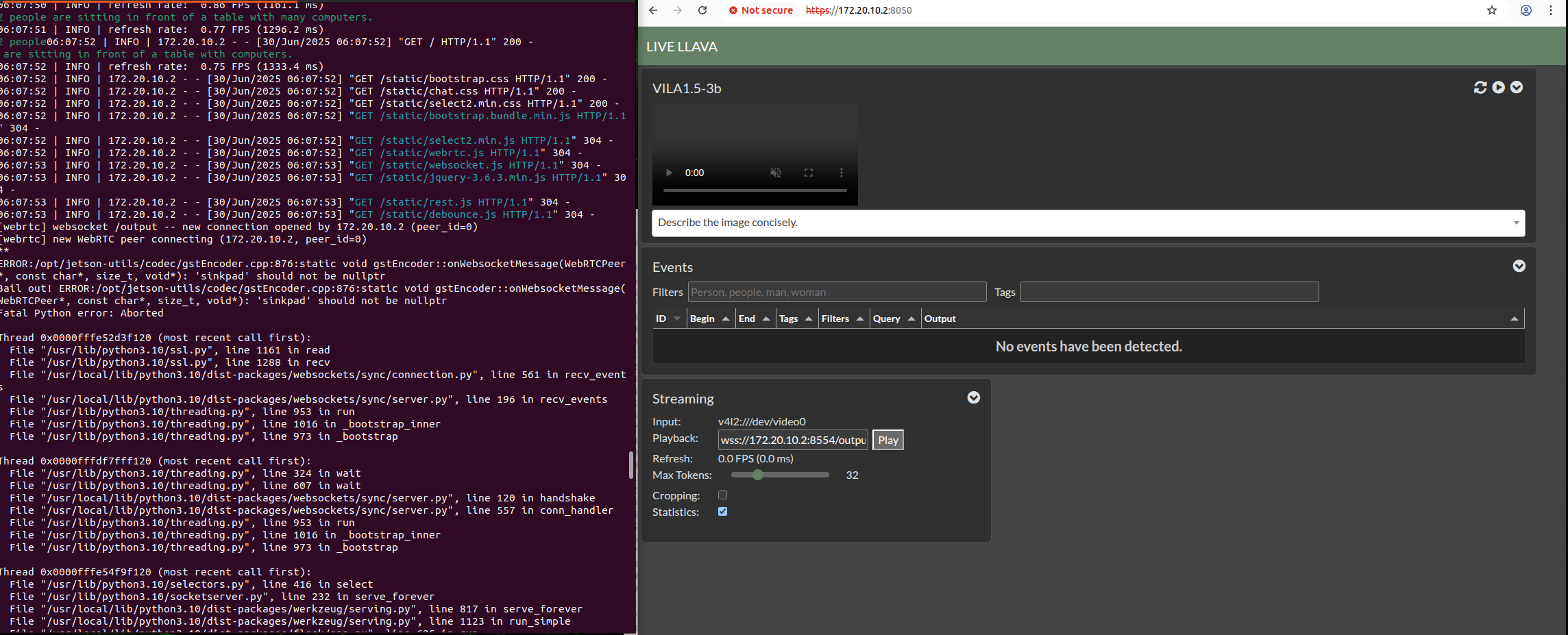

When I refresh the page to enter the web UI, the script exits on its own as shown in the left of the image.
I am still unable to view the camera feed as well from the web UI even though i have followed the steps as mentioned in the tutorial page here: Live LLaVA - NVIDIA Jetson AI Lab
The VideoQuery agent applies prompts to the incoming video feed with the VLM. Navigate your browser to https://<IP_ADDRESS>:8050 after launching it with your camera (Chrome is recommended with chrome://flags#enable-webrtc-hide-local-ips-with-mdns disabled)
