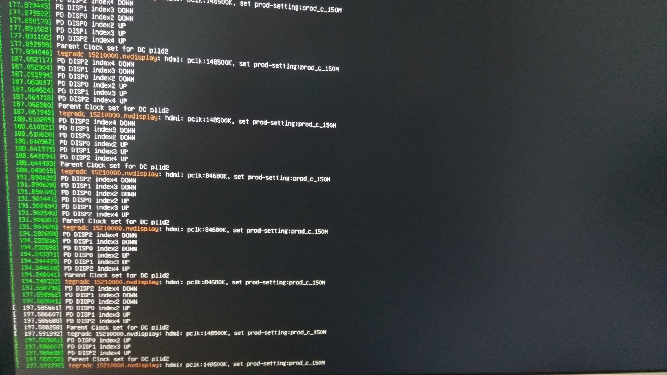

I’m having a login loop with a jetson tx2 running the jetpack 3.1.
I have tried the following solutions (without success) found on devtalk and other forum:
  • dpkg-reconfigure lightdm
  • reinstall lightdm
  • delete .Xauthority from the user home
  • add a new sudo-user
The command ‘sha1sum -c /etc/nv_tegra_release’ shows that everything is ok.
The software configuration is the one coming with jetpack3.1, plus opencv3 and pcl libraries built from sources.
The day before this happens I left the jetson running and after a while I come back and I did find it turned off.
I press the power button and it boot without errors. Could it be connected to the login-loop error?
In the same day I also have installed ‘libsdl2-dev’ using apt.
Can anyone help me?
Thank you

Using serial console or ssh you might want to run “dmesg --follow” and see if something prints during a failed login attempt. In a similar way you may want to run “sudo tail -f /var/log/Xorg.0.log” and see what shows up during the login attempt.

I have attached 2 photo of the output of the two commands.
This is indeed a bit odd. I say that because the messages might be expected in normal operation when someone logs in and back out. The 1920x1080 mode should be valid. My thought is that because the login prompt shows up it isn’t the login manager. Because lightdm itself was being manipulated, I highly suspect it is merely some configuration related to this causing its spawn to immediately be terminated due to configuration and not due to any crashed application.
Sometimes re-installing does not also reinstall items related to configuration. If you were to reinstall lightdm and it still fails I think it would narrow it down to configuration files. See if this changes anything:

It seems to have enough space available. Moreover, it seems to log in to the text mode successfully.
As I understand if you execute from the text mode
sudo init 5
or
startx
it will throw up a loop login.

FYI: I have installed openbox as suggested by @Andrey1984 and it lets me login while gnome is still with the login-loop
The issue seems to be Unity specific.
Since openbox doesn’t use the Unity it works.
