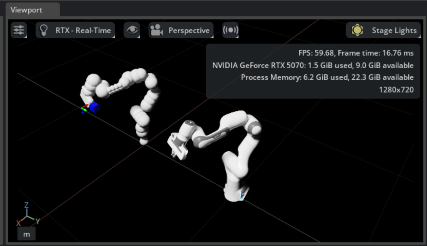

Lula RMPflow: Collision Spheres Do Not Move With Robot in Tutorial Code
I’m running the Isaac Sim 5.0 RMPflow tutorial code from the docs (Lula RMPflow — Isaac Sim Documentation). The only change I made was to initialize the Franka at a different world position (translated off the origin) and turn debug mode on.
The collision spheres show up, but they stay anchored at the origin and just “mirror” the joint motions instead of following the actual robot base. Collision avoidance is also happening relative to these ghost spheres, not the real robot.
I tried different call orders (e.g. setting base pose before/after visualize_collision_spheres(), resetting before visualizing, etc.), but the result is always the same.
Has anyone gotten RMPflow collision spheres to work when the robot isn’t spawned at the origin? Or is this a known limitation/bug?
Here’s my scenario.py (tutorial code with just the base translation line changed):

We’ve received your post and are checking with the development team about this issue. We will provide an update as soon as we have more information.
We’ve created an internal ticket for this.
I believe that there are several issues related to this issue:
Bug 1: The debug collision sphere position update does follow the robot’s transform (see the source code).
to solve this issue, we may need to get the robot base transform and apply for it. Users can modify the physics update function to correctly show the transform to it: e.g.
pos, ori = self._articulation.get_world_pose()
sphere_poses = self._rmpflow._policy.collision_sphere_positions(joint_positions)
TODO apply the transform to the sphere_poses.
However, the Lula visualization modules should take care of this bug.
Issue 2: A more serious issue is that the target and obstacle need to be added every time after reset. For example, we can rewrite the reset function:

Then the RMPflow can correctly follow the target and avoid the obstacle every time. See the picture blow:
Even though the debug collision sphere stays the origin, the robot’s obstacle-avoiding and target-following are correct.

Other issues:
The tiny gripper finger may hit the obstacle to break the motion planning pipeline. Therefore, in real practice, we may enlarge the collision sphere a little bit in the *_rmpflow_*.yaml file or the xrdf file generated by lula description editor.
Thanks for the clear reproduction case – it made it easy to track down.
The collision sphere visualization bug has been fixed in Isaac Sim 5.1.0. We verified this by running your exact scenario (Franka at [0, 1, 0] with debug collision spheres enabled) on 5.1.0 – all 55 collision spheres now correctly follow the robot base transform instead of staying anchored at the origin.
The root cause was in the _update_collision_sphere_prims() method: the sphere position update was missing the robot base rotation and translation that the initial creation path already applied. This is fixed in the isaacsim.robot_motion.motion_generation extension in 5.1.0.
@yizzhao’s workaround in post #5 (manually applying the base transform + re-adding obstacles after reset) is also correct if you need to stay on 5.0 for now, but upgrading to 5.1.0 is the recommended path since it handles everything automatically.
If you run into any further issues after upgrading, feel free to open a new topic and reference this one for context.
