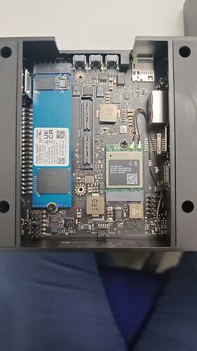

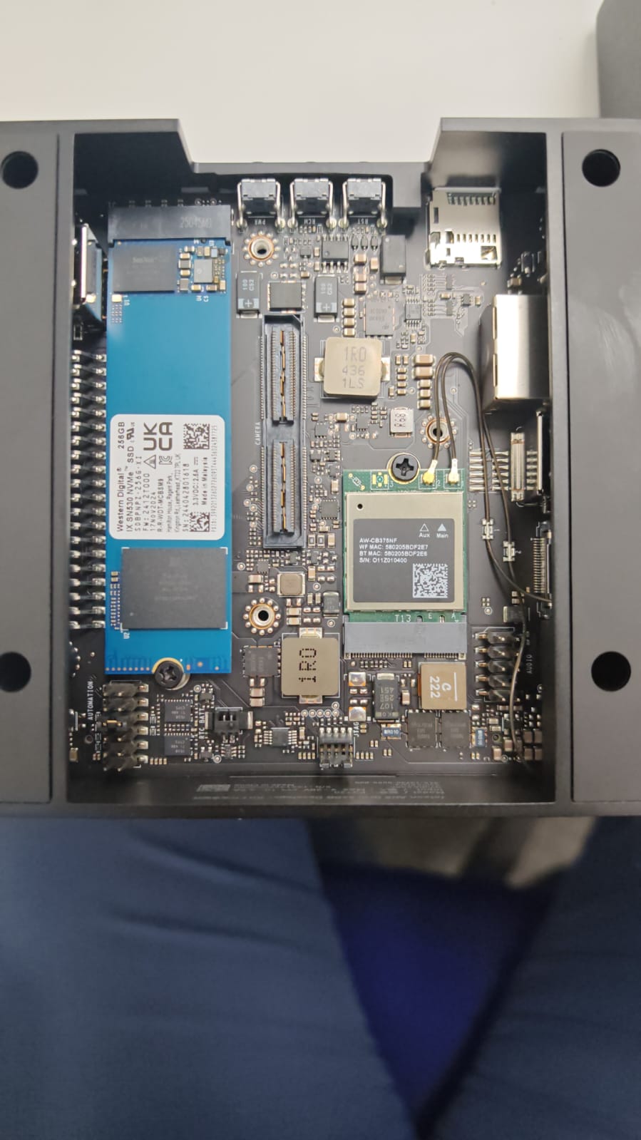

We have a Nvidia Jetson AGX Orin devkit and we want to use cellular connectivity. How can we install a LTE/5G module inside the kit. Your devkit has a M.2 E slot and we dont find a LTE/5G or any other cellular module that we can use with this form factor key.
There is any M.2 Key B to A+E Adapter Card that can be used in M.2 E slot and install TELIT LN920A6-WW
M.2 ENGINEERING ?
Our main goal for this dev kit is to have 3G /4G or 5G connectivity.
Looking forward to your feedback and thank you for your all support.

I wanted to ask if there is any M.2 E Key 3g/4G or 5G module that can be used directly, and whether NVIDIA has tested and validated any specific solution.

We don’t validate any 4G/5G modules on default Jetpack 6 release. Please consult with the module vendor and see if additional kernel configs are required. And follow developer guide to customize kernel.
