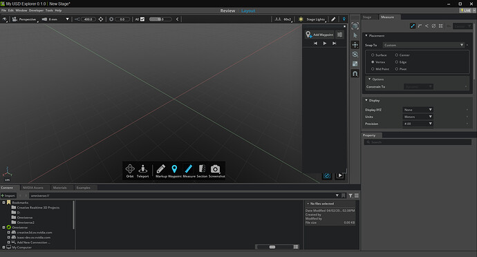

Measure Tool not working in USD explorer template, kit-sdk 107.0
Steps:
  1. Create a new project based on the USD explorer template.
  2. Ensure that the measure tool is in the dependencies in the .kit file (it was already there for me).
  3. Run the project.
  4. Go to the menu Tools → Measure.
  5. Observe that the Measure panel does not appear, although the checkmark gets toggled on the menu for the Measure Tool.
  6. Observe the following error displayed in red at the bottom status bar of the editor:
TypeError: Extension._show_window() missing 2 required positional arguments: `menu and `value`
Note: same bug with the editor template.

Hi, I am having the same issue, and I have the latest kit template too. 107, in Explorer.
It is working in Explorer when I am in review mode
I’ve got the same issue using the Composer Template in KIT 107 (main)

Hi @Richard3D , some more context. It appears that the Measure extension’s _show_window menu function is being called without the required parameters. I’ve confirmed this by going to the extension’s extension.py, and adding the following function:

it seems that the callback signature has changed - quick n dirty fix for me in measure tool extension:
def _show_window(self):
    if self._measure_panel:
        self._measure_panel.visible = True
[user]\appdata\local\ov\data\kit[your kit app]\0.1\exts\3\omni.kit.tool.measure-107.0.0+107.0.3\omni\kit\tool\measure\extension.py
