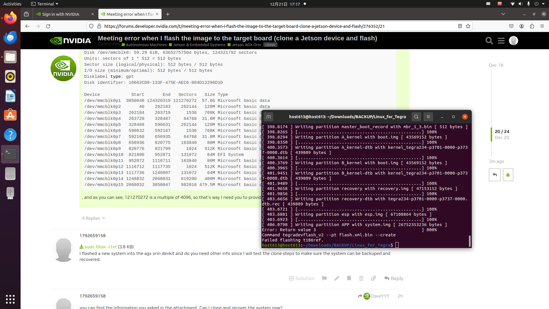

Meeting error when I flash the image to the target board (clone a Jetson device and flash)
sudo fdisk -l.txt (3.8 KB)
I flashed a new system into the agx orin devkit and do you need other info since I will test the clone steps to make sure the system can be backuped and recovered.
you can find the information you asked in the attachment. Can I clone and recover the system now?
I reflashed the system again, and it seems that the same issue has appeared. Can you please clarify whether you can help resolve this problem?
Can you please use your product to try and see what the bug actually is?
The same issue as before has occurred.

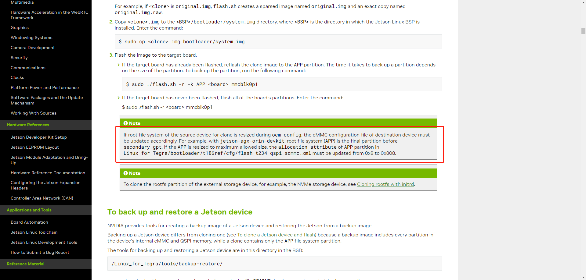

This link resolved my issue: Flashing Support — Jetson Linux Developer Guide documentation"
