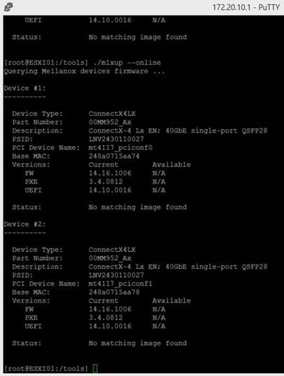

Hello, I need your help to solve the problem I have experienced in a customer.
I did not perform the Mellanox frimware upgrade on VMware ESXI 6.5 using the following commands.
./mlxup --online
./mlxup -i /tools/***.bin
./mlxfwmanager
fw current version is 14.16.1006 web page version is 14.22.1002
Hi ,
It’s OEM adapter , please contact the OEM vendor (Lenovo) to get the latest firmware .
P/N - 00MM952_AX
PSID - LNV2430110027
http://www.mellanox.com/related-docs/firmware/ConnectX_Family_Adapter_Cards_Firmware_Mapping_for_Lenovo.pdf http://www.mellanox.com/related-docs/firmware/ConnectX_Family_Adapter_Cards_Firmware_Mapping_for_Lenovo.pdf
