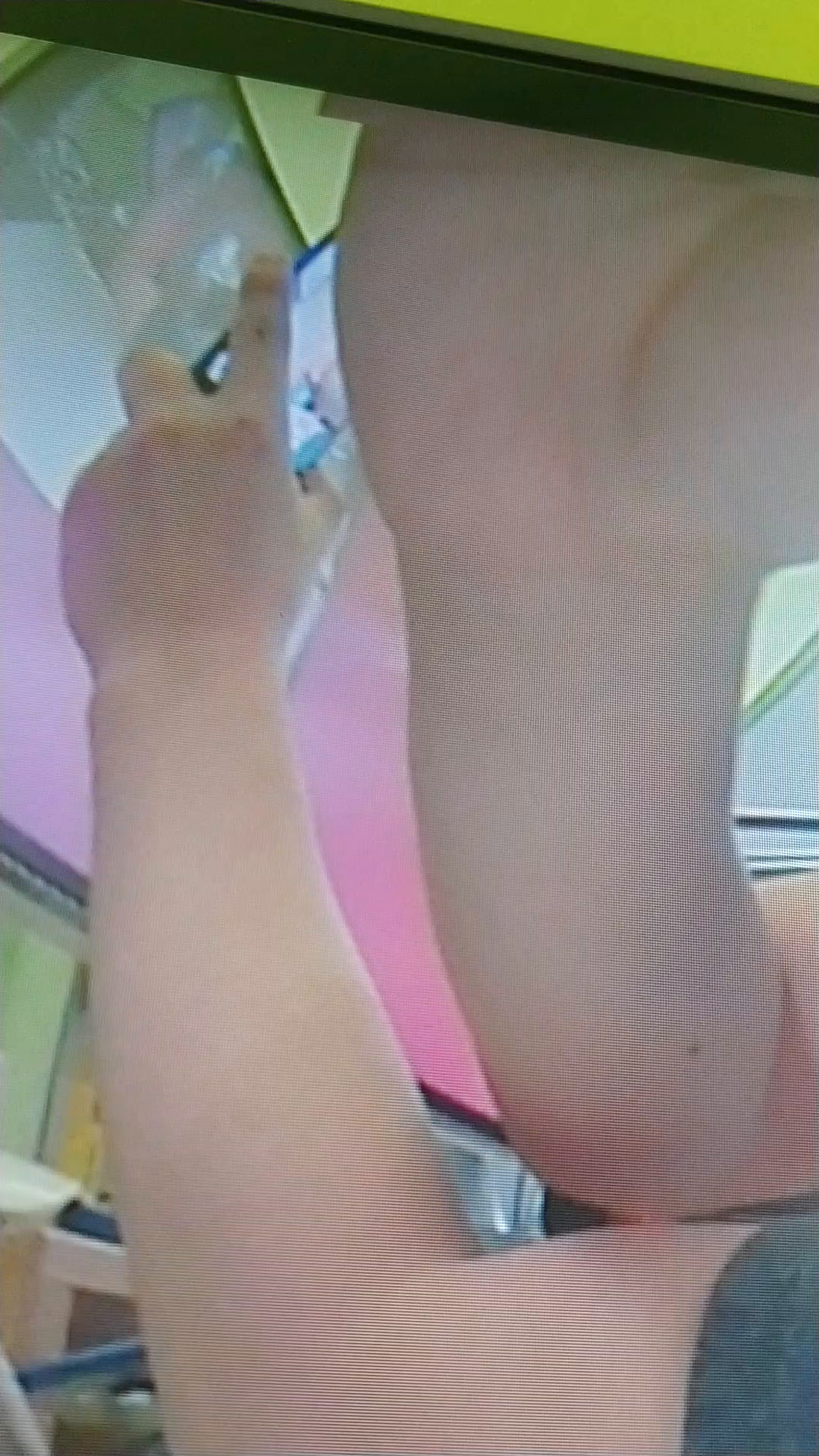

I am trying to connect a yuv422 camera(720p, 30fps) on a tx2 board.
I have a problem. I can see the time difference occurs at the top of the camera image.
It seems there is a mipi timing issue.
How could I handle this issue?
