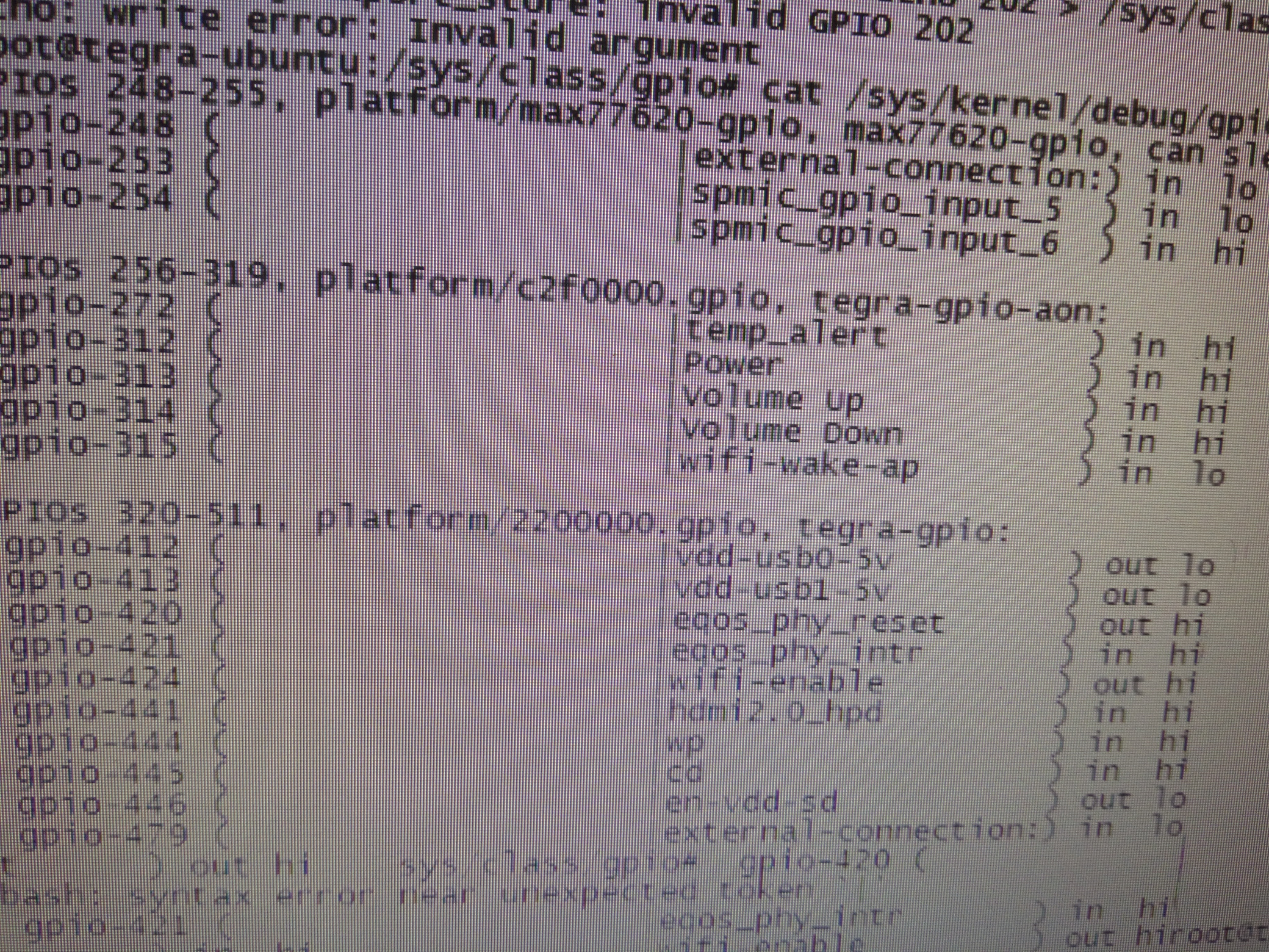

I use TX2 for development, and after the kernel starts, the mouse keyboard can’t be used
, but I use the TX1 it can work fine , can you tell me the tx2 kernel what should I do that I
can use the Mouse and keyboard .

But the keyboard can’t be used, I can’t enter CTRL-ALT-F2,

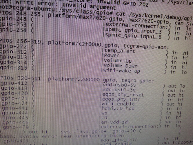

I found that the mouse and the keyboard have no electricity. If the 3221 chip did not read 5V, it would have an impact on the mouse keyboard.
Most of the time there should be 5V on the USB power (there are some exceptions, but I doubt those apply). Is this modified in some way? I don’t know how the GPIO and device tree information would show up without something running post-boot…is this a regular developer board which works with TX1 but not TX2?
