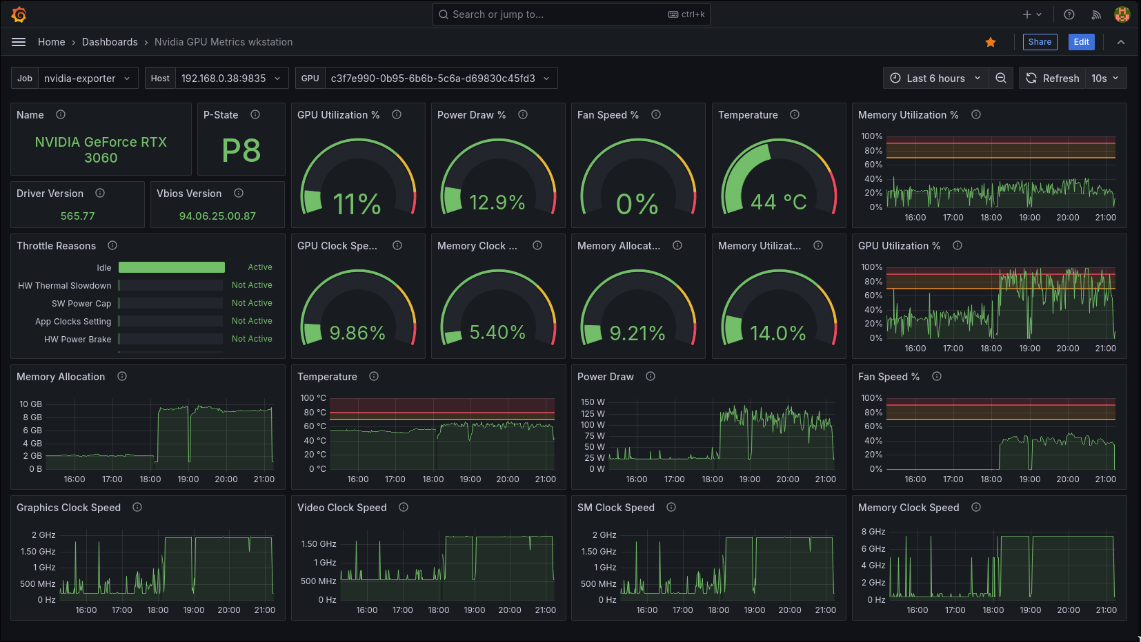

Here you can find the gpu metrics as well, you can see in the spikes when I started playing the game and when I stopped

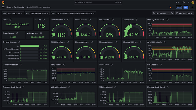

a new update oh this, after upgrading to the kernel version 6.12.8, the issue still appeared, I now believe the xid 109 error is caused by the greeter, being able to launch my desktop environment from a tty instead of using sddm seems like a workaround for this issue. here’s another bug report log.
nvidia-bug-report.log.gz (728.0 KB)
and another screenshot from grafana
the first dip found at around 19:00 is when the error appeared, after that I stopped the display-manager service and launched hyprland from the tty, which allowed me to play 2h at least which is when I closed the game
