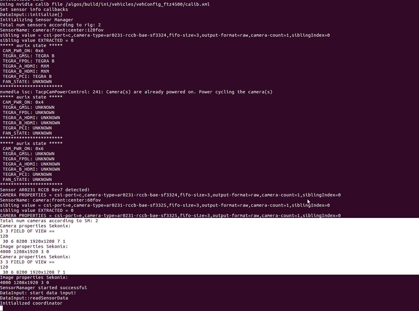

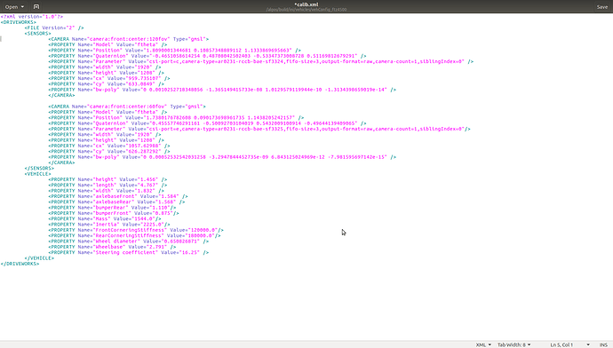

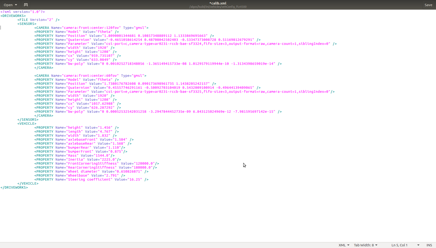

Please find the attachment of the rig file that we are using (calib_file.png). Currently we have 2 Sekonix cameras. One is a 120° FOV (sf3324) and another camera is a 60° FOV (sf3325).
We are already using dwSensorManager_initializeFromRig() function and both the cameras are properly initialized. (please see the highlighted section in the above attached image).

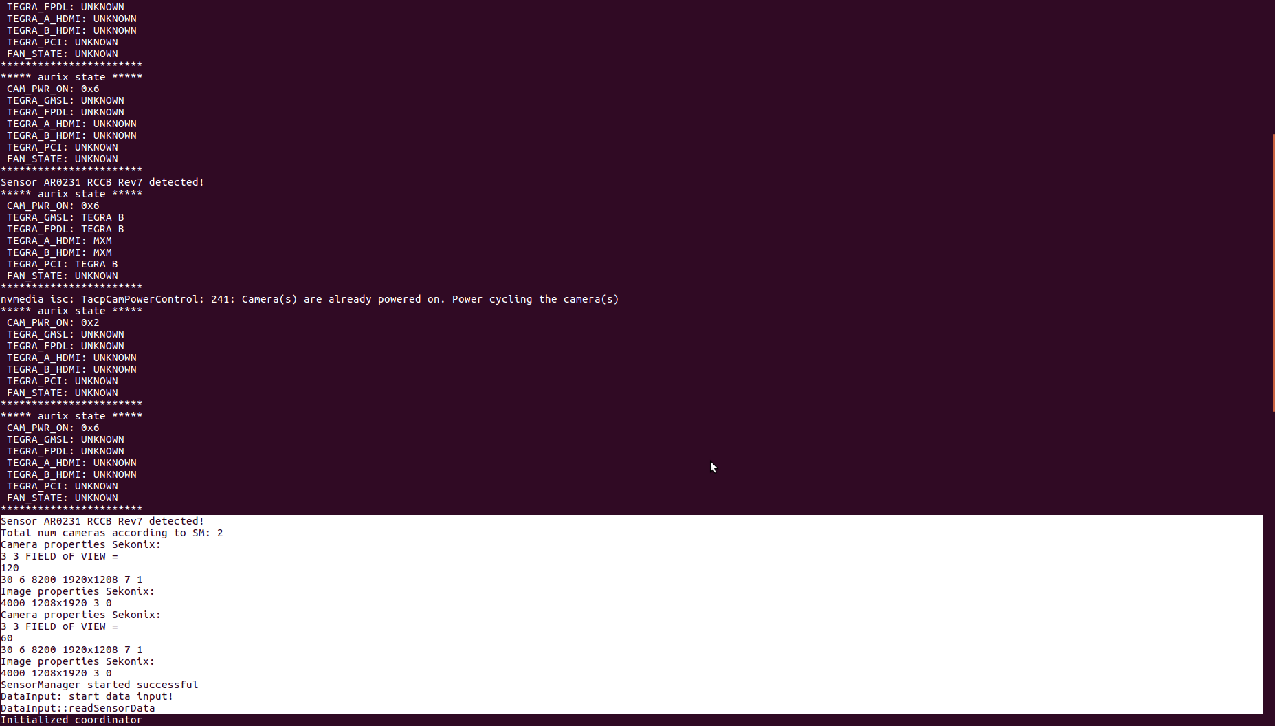

However, when I am trying to initialize a Sensor Manager and then use the function dwSensorManager_addCameraSensor(), only the camera defined first in the rig file is initialized and the 2nd camera, which is a 60° FOV is also being initialized with the 120° FOV camera’s properties. (please see the highlighted section in the image Cameras_Wrong_Init.png). For verification purposes, I have also printed the camera properties extracted using the function dwRigConfiguration_getSensorParameter.
I am not sure where I am going wrong with this. Is it even possible to initialize the cameras and the other sensors using multiple instances of the Sensor Manager?
