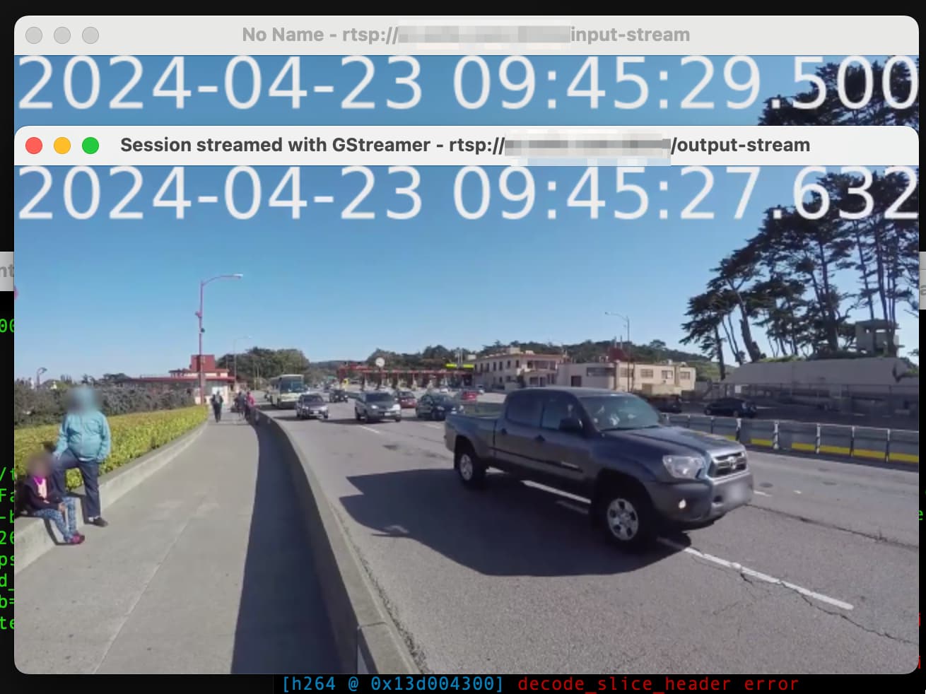

If it would still need more evidence, here it is.
I’m pushing a NY video from my PC to the RTSP server. The two inference pipelines - the one without nvstreamdemux and with lower latency and the other - are pulling the video from the RTSP server and pushing the inference results back as another stream.
Then on my PC I’m pulling both - the original and the annotated stream - and displaying it side by side

The results in video:
Lower latency:
Higher latency:
I would estimate the latency addition caused by nvstreamdemux to about 2 seconds. For what reasons ever.
That is really, really weird…
I have now enabled display-clock for nvdosd. With both pipelines I see a general latency of 1 s, which would be ok. One second means: I have a real-time clock aside here and my camera image going through the inference. The timestamp in the output video of the inference is 1 second behind. Good so far and completely acceptable.
When I for instance raise my hand in the (real-time) second 35 of a minute, then the inference display shows that move with exactly the timestamp 35 one second later. But only, if nvstreamdemux is not in the pipeline. So the timestamped video really shows the real time situation at that time. Perfect.
But with nvstreamdemux in the pipeline, the movement is shown after a delay of totally 3 seconds and the timestamp in the video is 38 for the movement. Note: The total timestamp difference between the video seen and the real time clock is still 1 second, it is just so, that the video - correctly timestamped - is in reality 2 seconds older.
Conclusion: The demuxer is somehow needing additional 2 seconds to feed the video to the nvdsod, where it gets timestamped correctly. But it has been artifically aged. :)
And there is no configurable way around. This component is useless for real-time applications.

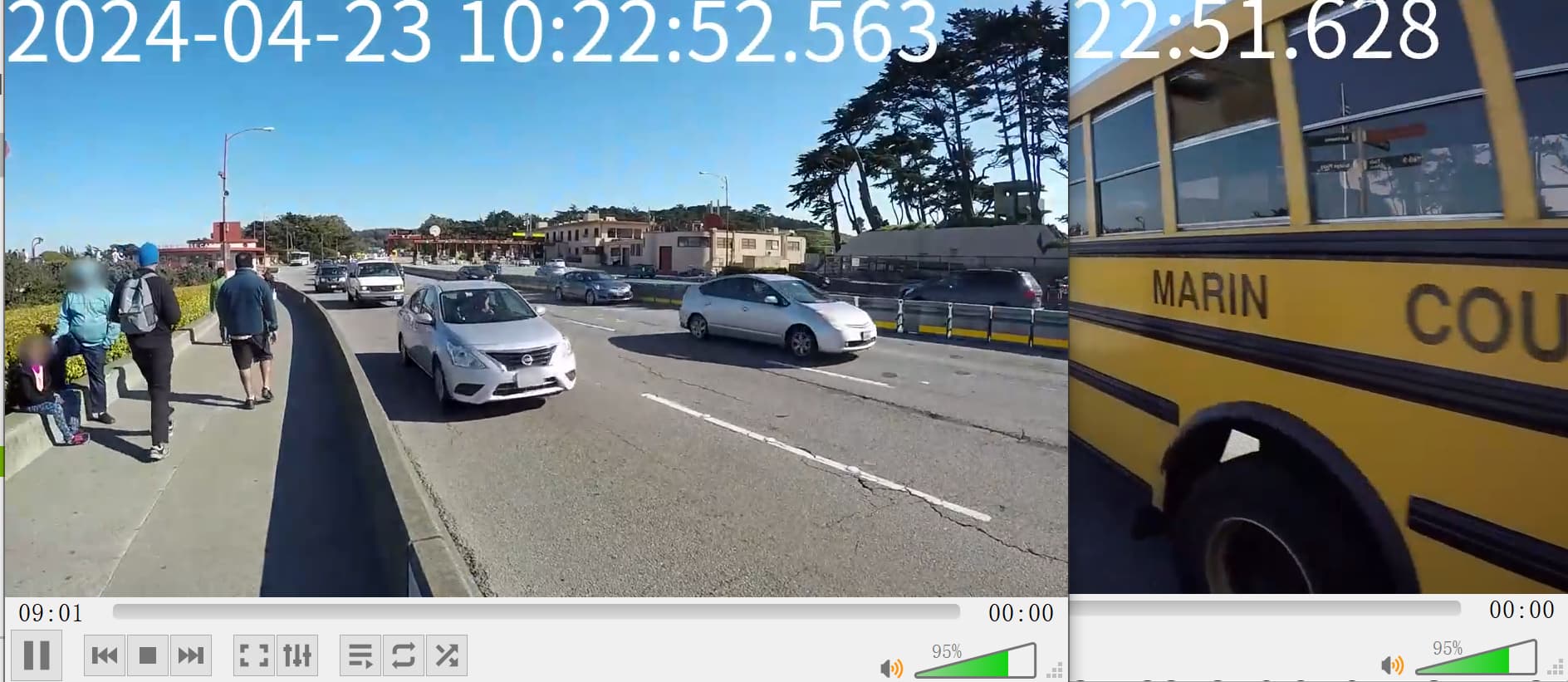

On my side, according to the pipeline you provided, the latency is about 1s with and without the nvstreamdemux plugin.
left: with Nvstreamdemux right:without nvstreamdemux
It may take some time to analyze whether this latency (1s) is normal.

I did use the pipeline you attached. We don’t have to give you the wrong presentation. Let me show you my steps step by step.
  1. Please refer to our FAQ to build a rtsp source Build rtsp server
    Note: Please use the command below to generated the video with timestamp.
ffmpeg -re -stream_loop -1 -i sample_720p.mp4  -vcodec libx264 -vf "settb=AVTB,setpts='trunc(PTS/1K)*1K+st(1,trunc(RTCTIME/1K))-1K*trunc(ld(1)/1K)',drawtext=fontsize=100:fontcolor=white:text='%{localtime}.%{eif\:1M*t-1K*trunc(t*1K)\:d}'" -an -f rtsp -rtsp_transport tcp rtsp://127.0.0.1:8554/stream0
  1. Use our deepstream docker: nvcr.io/nvidia/deepstream:6.4-triton-multiarch to run the pipeline you attached:
gst-launch-1.0 nvstreammux name=mux batch-size=1 width=1280 height=720  ! \
nvv4l2h264enc ! rtspclientsink location=rtsp://localhost:8554/output-stream \
uridecodebin uri=rtsp://your-server:8554/input-stream ! mux.sink_0
nvstreamdemux name=demux demux.src_0 ! \
  1. Use VLC player to play the 2 rtsp sources generated.
The image I attached is a comparison of two generated rtsp sources played on my laptop using VLC player.

With nvstreamdemux output now is 2 seconds behind, no doubt.
Pipeline 2:
uridecodebin uri=rtsp://127.0.0.1:8554/input-stream ! mux.sink_0
I was using ffplay for consumtion, but even with a gst-launch pipeline same results. 2 seconds. That’s not new. I also don’t believe that VLC would improve that.
