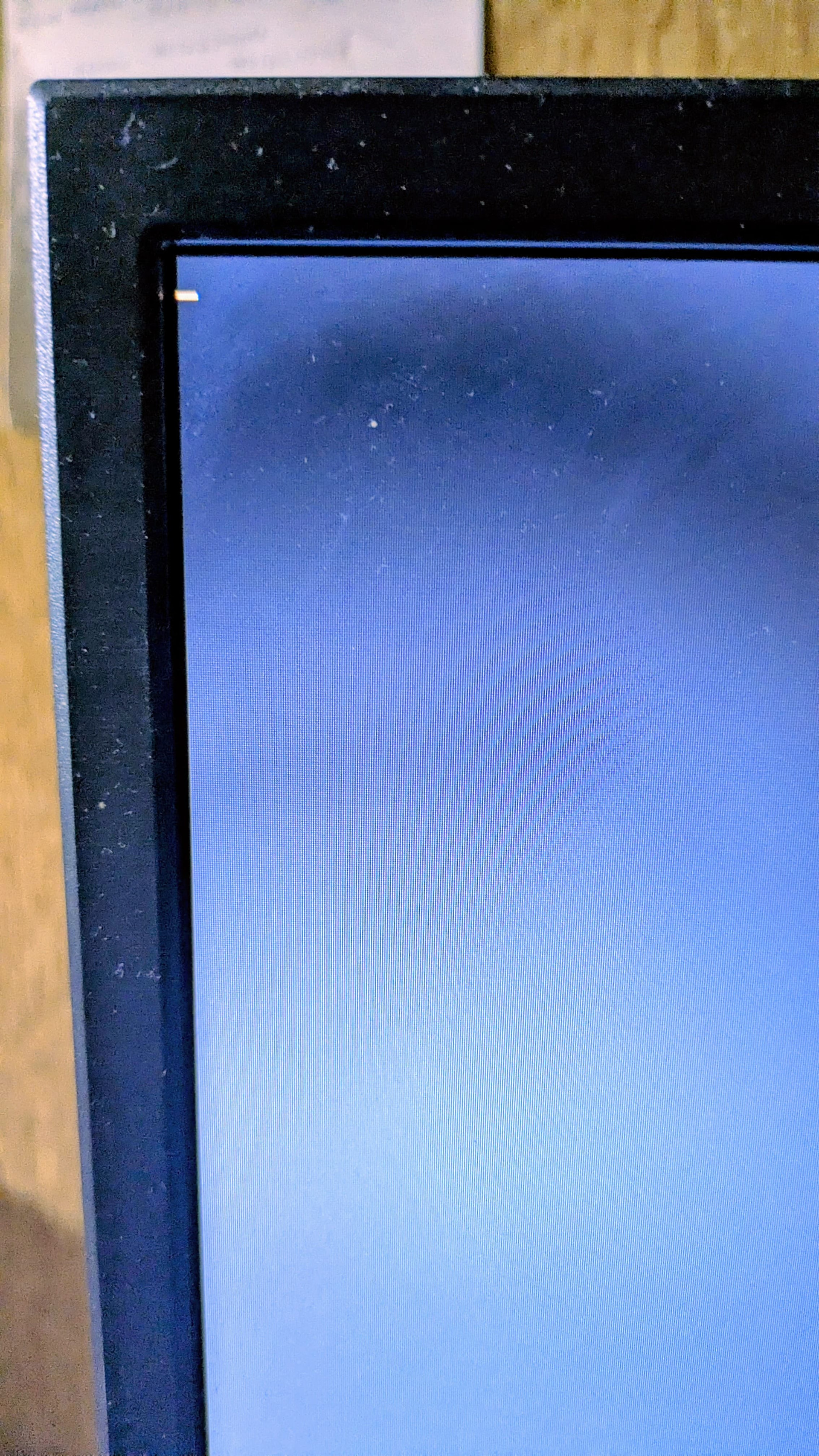

Please run the last command with sudo privileges
sudo systemctl start gdm gnome-remote-desktop cups cups-browsed
its stuck here, and that underscore is continuously blinking, after the above commands
This certainly seems like an issue with your driver installation? The gnome-extensions you installed may not be compatible. Which extensions did you try to install? Exact commands would be helpful.
  • You can try the update process to see if it fixes your packages
sudo apt update
sudo apt dist-upgrade
thank u so so so much!! FInally worked, via reimaging from clean slate!!
