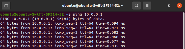

I’ve tried connecting my host pc (ubuntu, dual boost) with jetson directly through crossover ethernet cable. After that, I manually set the ipv4 of the jetson and host to be 10.0.0.1 and 10.0.0.2.
It seems to be able to ping between them.
However, when I tried to install SDK components this error happened
Let me ask directly. Is the PC that running sdkmanager able to ssh or scp file to your jetson through that IP 10.0.0.1?
Yes, that’s the problem. Thank you so much. I think I’ve completed the installation.
