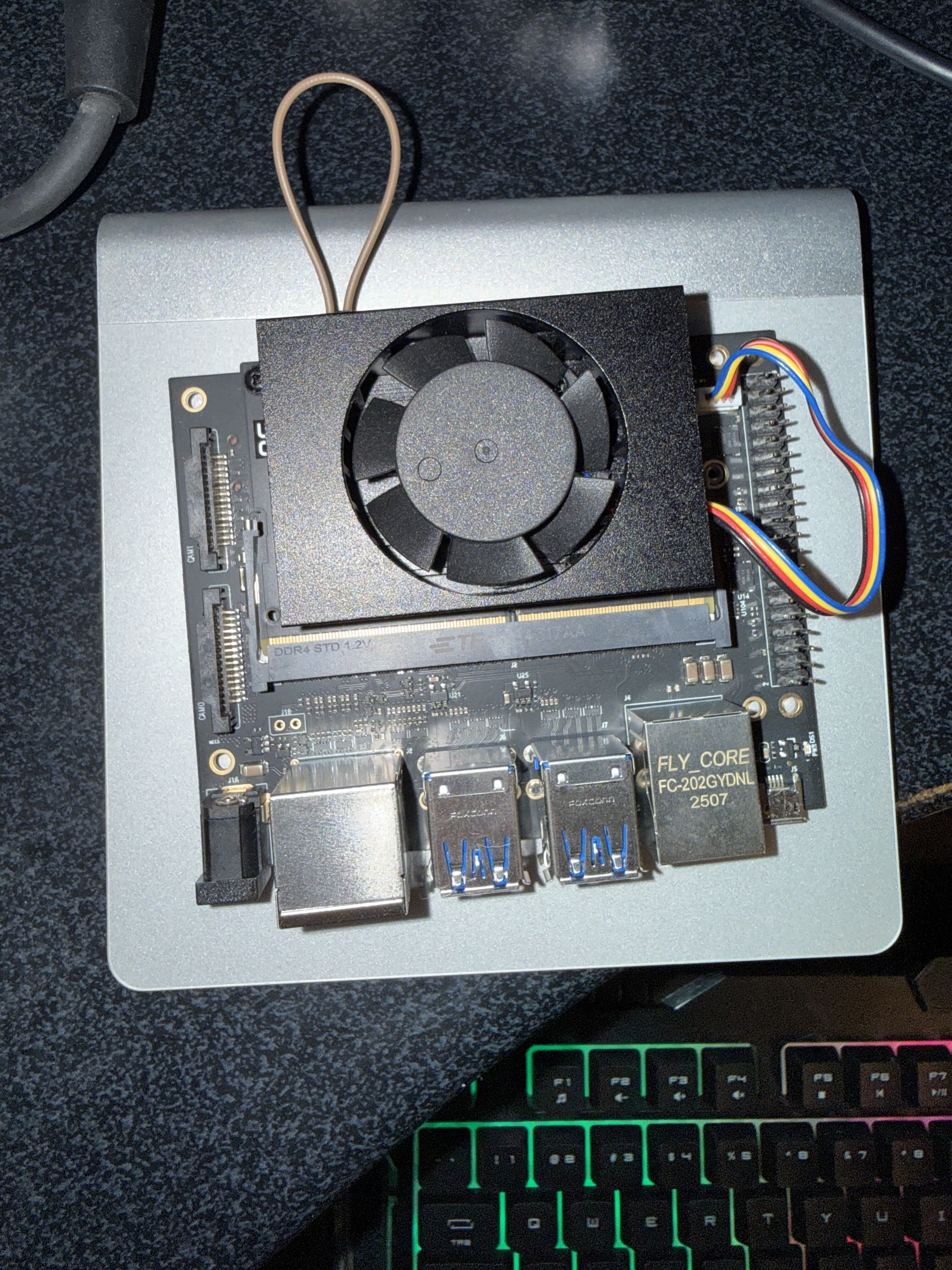

I don’t see the power jumper on my board. Here is a picture.
I just checked the whole photos you shared of this board.
Actually that carrier board is not a NV devkit. Thus, what @linuxdev and I shared are not applicable to that board.
In brief, the carrier board you are using is made from some other unknown vendors.
Is there any power LED on that board to indicate your board is powered on?

Also, could you clearly take a photo of what is the exact pin you put the jumper on your board?
Your host PC could only detect your Jetson when it is in recovery mode and you have to use micro usb connected.
Please be aware that your photos didn’t show that thing at all. We only saw a wire is there.
I don’t want to say it must be such mistakes but we did see some users put the jumper in the wrong pin before…
I don’t see how you really connect things after you changed to use power barrel. Show that photos as well.

None of the developer kits come with a battery backup. Can you say where this was purchased? If we can figure that out, then the information for flash will likely come from that vendor (and the firmware/device tree would also differ; perhaps a patch to NVIDIA’s flash software, or perhaps their own flash software).
I ordered it from Amazon. The seller was WayponDev according to Amazon.
Could you take a photo of all the things connected together when you attempted to flash your board?
I assume power barrel/micro usb cable/ jumper should all be connected there.
This is currently setup for flashing, but no detection in SDK Manager.
