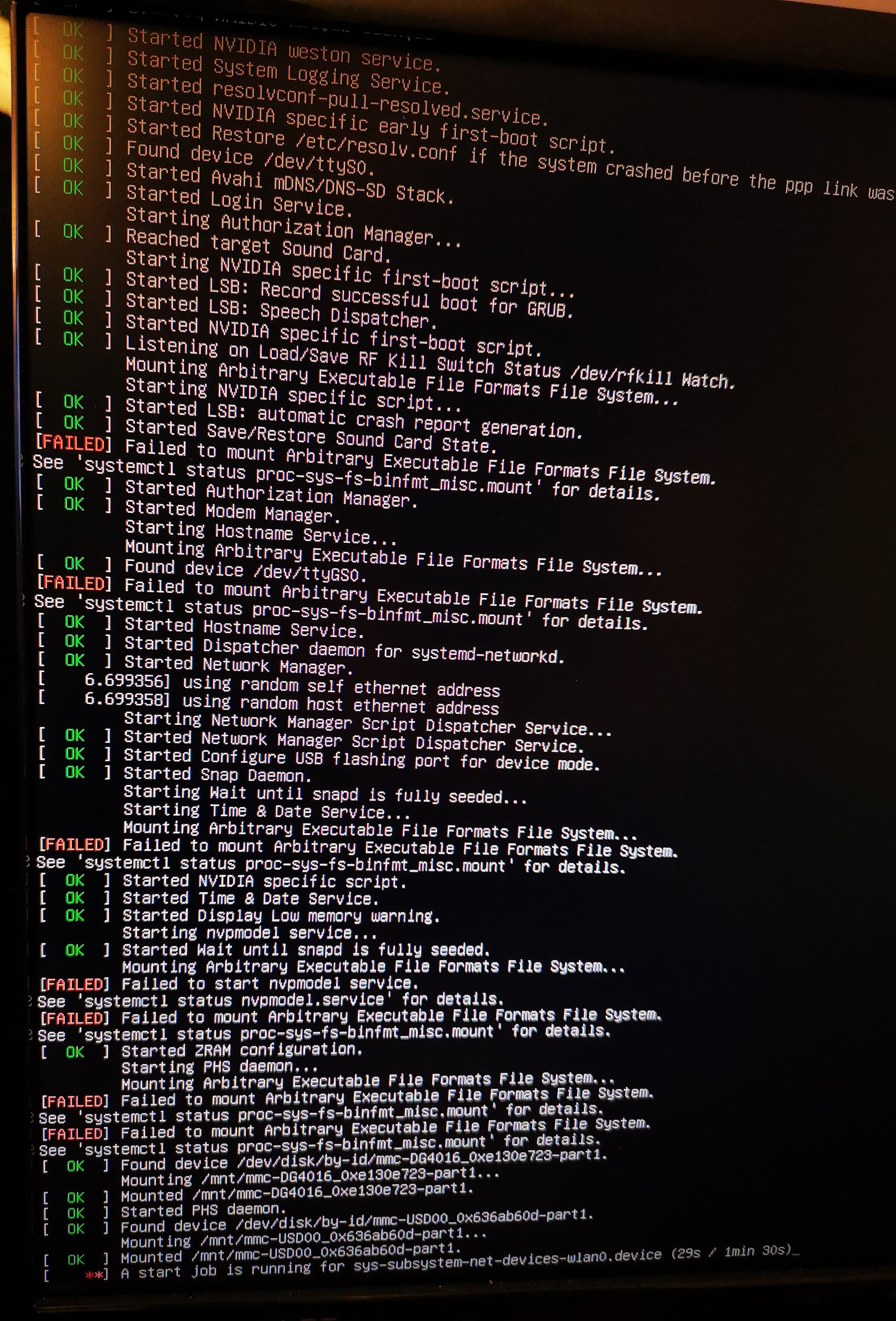

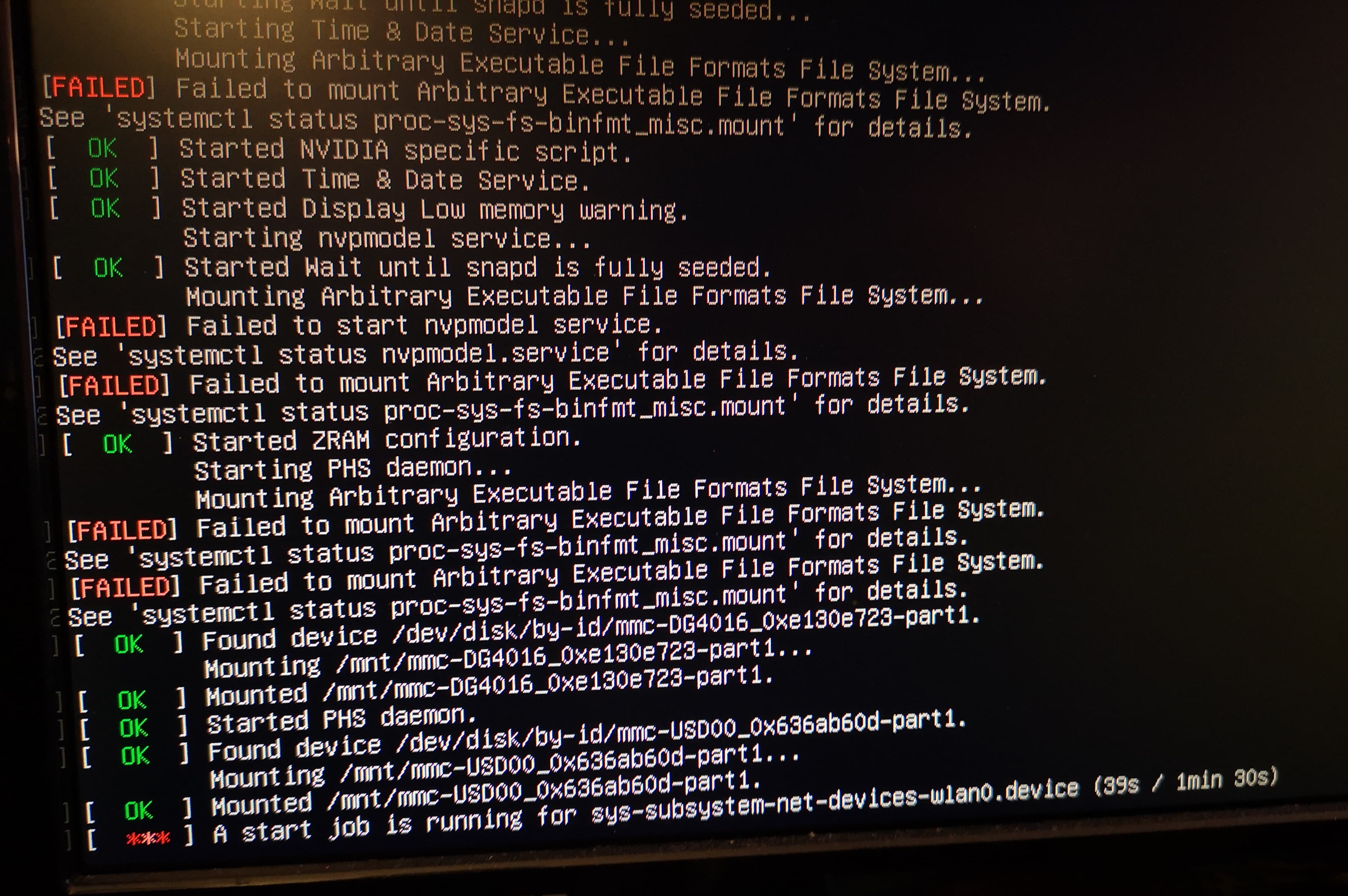

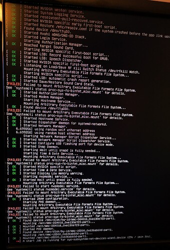

Hi here. Hope you are well!
After i performed
sudo apt update
sudo apt apgrade
My nano can’t boot. I see the Following errors in the console (see attachments). Did anybody have the same issue? How to fix?

We don’t experience this issue. Would see if other users can share experience.
It would be great to re-flash the system to get a clean environment. Would suggest re-flash to Jetpack 4.6.4 through SDKManager.

The error proc-sys-fs-binfmt\_mis.mount it’s sudo apt install binfmt-support are present in you system?
What error returned Sudo systemcl status nvpmodel.service?

I don’t know enough to solve this (I’m doing a lot of guessing here), but if you are using an emulator (such as QEMU), then sometimes the order of installing the qemu-user-static package can change things. I have no idea if this is the problem or not.
Also, note that `nvpmodel.service` is part of the standard NVIDIA installation related to power control. That means it accesses “`/proc`” content for either examining or changing driver settings (each file there is really a driver pretending to be a file, and not a real file on disk). Not having the NVIDIA kernel would result in not having the ability for `nvpmodel.service` to function. This might also be related to device tree since some wiring has multiple possible function, and differs across different carrier boards (e.g., it might work on a dev kit, but fail on a third party carrier board until the correct device tree is used).
