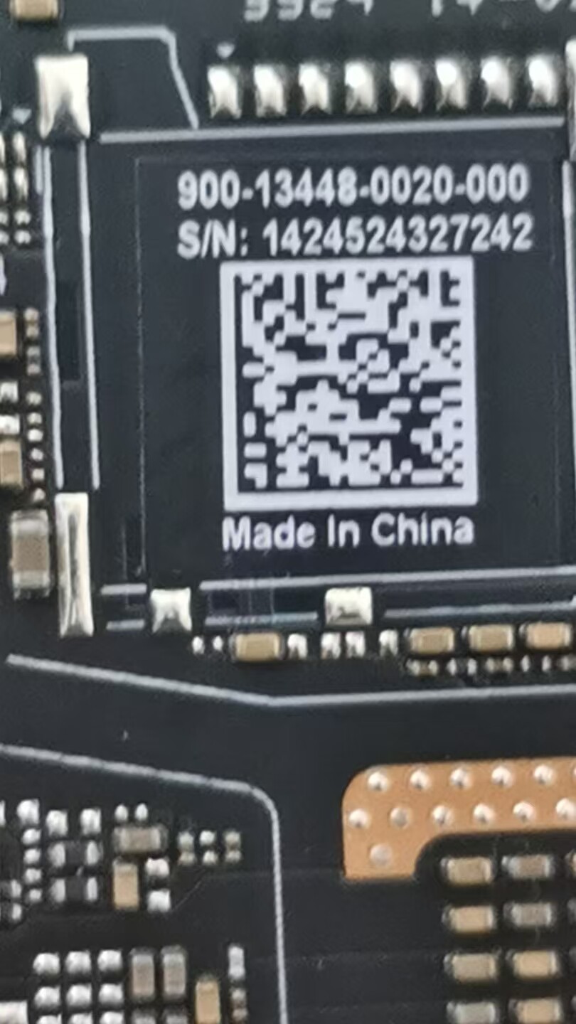

您好NV! 最近发现nano模组烧完系统卡在了nvidia的logo那里,试了jetpack4.x的好多个版本,全是一样的情况,日志为串口打印信息,请协助分析一下是什么问题?
It seems like the similar topic discussed in this
Please don’t panic. According to your log,
[0008.896] Adding plugin-manager/ids/3448-0000-200=/i2c@7000c500:module@0x50
[0008.903] pm_ids_update: pm id update successful
[0008.907] pm_ids_update: Updating 3,ae, size 256, type 0
[0008.937] pm_ids_update: The pm board id is 3449-0000-200
[0008.944] Adding plugin-manager/ids/3449-0000-200=/i2c@7000c500:module@0x57
[0008.951] pm_ids_update: pm id update successful
[0008.982] Chip UID is 00000001644476451c00000016fe8400
[0008.987] Add serial …
Could you change other power supply to cross check whether the issue exist?
Also one question to confirm: Is your Jetson Nano a dev kit or the custom carrier board?
