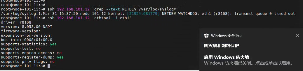

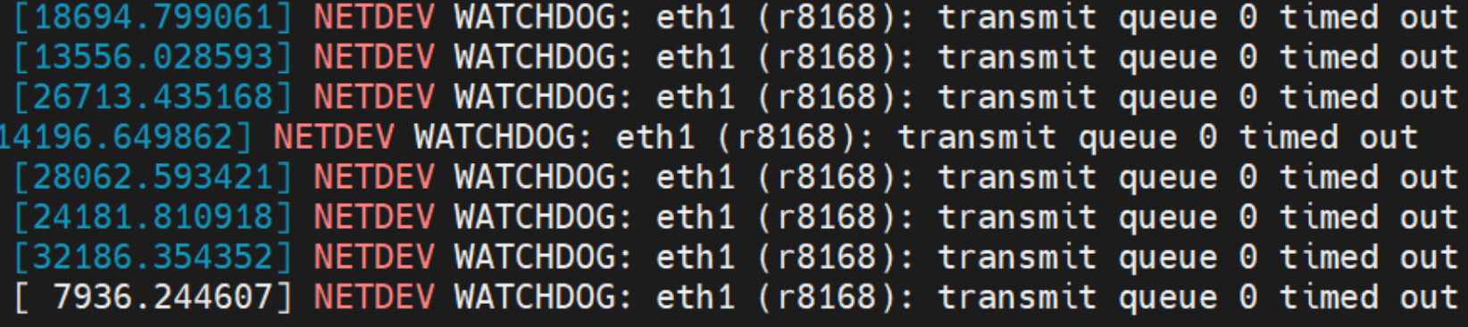

NETDEV WATCHDOG: eth1 (r8168): transmit queue 0 timed out
英伟达团队您好,在使用贵公司产品遇到了网络问题,在此请教一下思路!
模组类型:XavierNX 16GB;
系统版本:Ubuntu20.04 L4T: 35.4.1 (jetpack5.1.2)
使用网口为eth1:
在使用中出现网络不通的情况,通过日志发现以下信息:
我们通过论坛搜索发现(https://forums.developer.nvidia.com/t/netdev-watchdog-eth1-r8169-transmit-queue-0-timed-out/306649)也有这种情况,是r8169和jetpack5.1.1版本之间也有同样问题。
想问一下,针对r8168和jetpack5.1.2之间兼容的问题,能否通过升级网卡驱动至8169解决,如果不能解决,还有没有其他的解决方案。如果升级jetpack版本设涉及东西比较多,假如升级了jetpack版本还会不会有这个问题,具体升级至哪个版本。感谢!

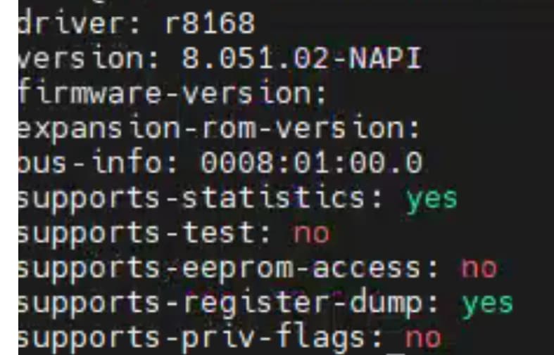

Yes, the fix is in Jetpack 5.1.5. You may upgrade to the version. Or manually merge the commits to previous version:
r8168: update driver to 8.053.00
r8168: Change file permissions of source files
r8168: Fix -20C 10mbps failure in Mods test
r8168: Disable 10M EEE
You can download kernel source of 5.1.5 by running source_sync.sh. And the commits are in kernel/nvidia
Thank you for your support!
We have upgraded the network card driver (r8168) for the existing Jetpack 5.1.2 environment, but the previous error still occurred during operation. So, may I ask where the problem lies?
We would suggest add some prints in the driver code to make sure you are loading correct ko file. The path is changed so probably it does not load the correct ko file.
Hello, we have upgraded the network card driver for Jetpack 5.1.2 according to the plan you provided, but the previous error still occurred in the end. So I want to confirm two points with you: first, whether upgrading the network card driver in Jetpack 5.1.2 version can solve this problem; Secondly, if the Jetpack version is upgraded to 5.1.5, will this issue be completely resolved? Or is it true that after upgrading to the Jetpack version, users who have encountered the same issue have completely resolved the problem? I want to get a real and accurate answer, which is important for me to take the next action. Thank you for your reply!
