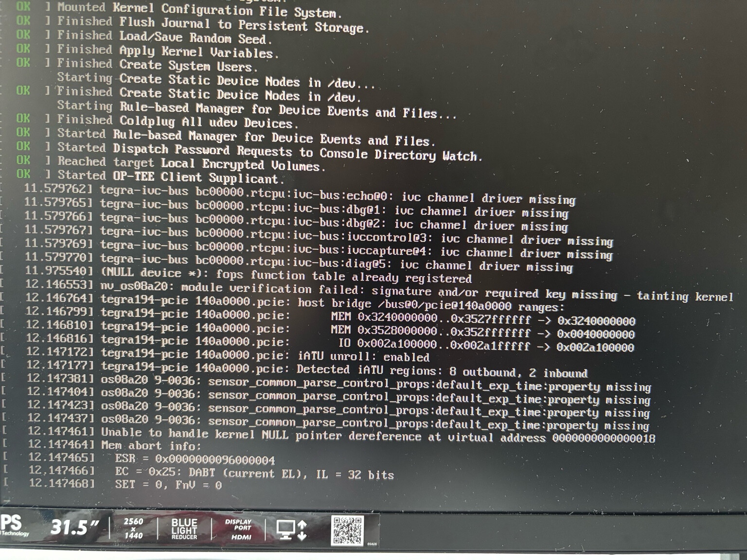

After binding the driver, syncing, and rebooting, the Jetson didn’t boot and stayed here:
ing
I couldn’t edit the extlinux.conf after this to put the os08a20 driver in the blacklist.
The problem seems to be that something has conflicts between DT and the driver. Or something else I don’t know.
Please take a look at the files and help me stream this sensor.

hello ms.alijani,
there’s error log regrading to property missing and then kernel panic with NULL pointer dereference.
I assume it’s due to you did not define necessary sensor property. the issue should be on sensor device tree side, during kernel initialization stage, it’s step for camera device registration to setup a video device node to linux kernel. sensor probing only run when you loaded the kernel module.
please compare your sensor device tree with reference driver.
$public_sources/kernel_src/hardware/nvidia/t23x/nv-public/overlay/tegra234-p3767-camera-p3768-imx477-A.dts
Hello Jerry, Hello Eduardo,
The property missing was about the missing exp_time. which was empty in modes in the Device Tree, I corrected this missing item.
After that I ran insmod to load the driver but the Jetson rebooted.
and the only message was in dmesg and serial report was:
