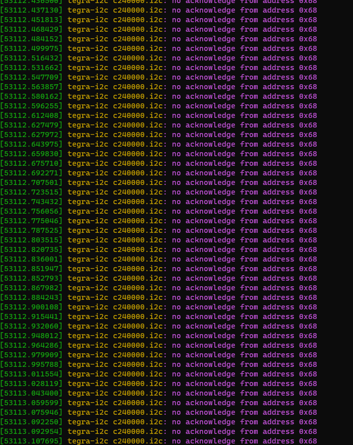

Hey,
I have a Xavier DK with an IMU attached to it, when the device is not connected it spams this message in dmesg and fills up the device space. currently, I am not able to push the fix to handle this in code.is there a way to stop this ?
i have tried using ftput to edit the bus tree and change it okay to disabled but no luck.
For a quick fix I only need the logs to stop spaming as it stops the device from turning on and eats all the space

Not the bus driver. Can you check the kernel message to check if can figure out what slave device access the i2c
By running the command fdtget /boot/tegra194-p2888-0001-p2822-0000.dtb i2c1 -p
I dont see anything here ,how do I get the slave address
I think i found it
its 0x0703
this is used to initiliazie the connection
ioctl(mpu6050::file, I2C_SLAVE, addr)

For removing the mpu6050 driver you need to build customize kernel image for it.
https://docs.nvidia.com/jetson/l4t/index.html#page/Tegra%20Linux%20Driver%20Package%20Development%20Guide/kernel_custom.html#
Hey thanks for replying,
i dont think I can do it . I am constrained by a runtime environment .I am looking for a way to change this in run time
In the case of a driver which is integrated (the “=y” instead of “=m”), then I think rebuilding the kernel Image file might be mandatory to stop the feature. Most (all?) of the features for blacklisting a driver seem to require the form of a module. What you are seeing in the other replies is a need to rebuild the kernel, which in turn means needing to configure the kernel normally, and ending with removing just the CONFIG_IIO feature (thus the rest of the config is not changed).
