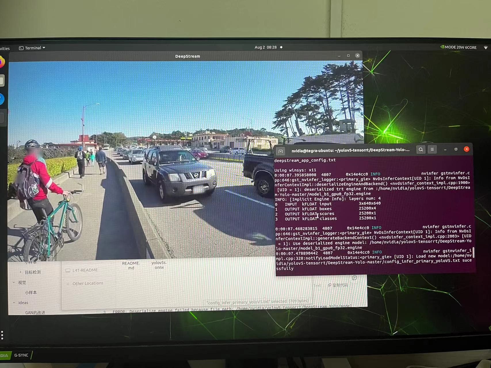

No Detect Result
• Hardware Platform Jetson Xavier NX
• DeepStream Version: 6.1
• JetPack Version 5.0.1 DP
• TensorRT Version 8.4.0
• NVIDIA GPU Driver Version CUDA 11.4
**• Issue Type questions **
when I run deepstream, it dont show the detect result, why.
And in deepstream folder, i have the label file-“labels.txt”. The yolov5s model is not custom.
this is my configuration file:

  1. which sample are you testing? here is a yolov5 sample.
  2. can you add log in NvDsInferParseYolo to check if this function is triggered?
  3. if still can’t work, can you share the whole running log?
