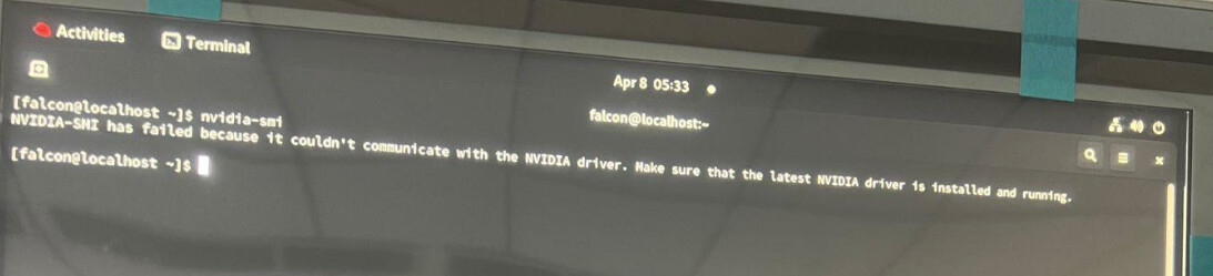

  1. Customer by mistake executed sudo dnf update command, which resulted in upgrading of the RHEL OS version, from RHEL 9.4 to RHEL 9.6
  2. With this Nvidia-smi command is no longer working and they are getting the below error.
  1. Could you provide any solution for this.
Note: They have only primary display at customer site and dont have SDOUT monitor ( secondary display NVidia GPU).
Hi @nagesh_accord , I think the error is due to a driver version mismatch. The dnf install command might have installed a newer version of the driver without completely uninstalling the older version, which could lead to this error. I think a complete uninstall/purge of the existing driver and a reinstall of the driver should fix this issue. It would helpful if you can get a copy of the bug report from the customer. That would help us to check if it is indeed the same issue, or a different one.

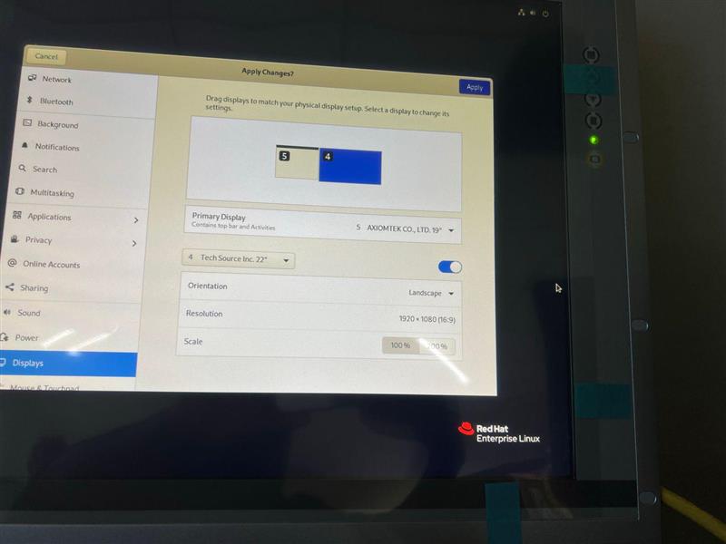

Apart from the above query we have few more questions regarding display resolutions issues for Primary monitor coming directly from SBC supported by NVidia driver..

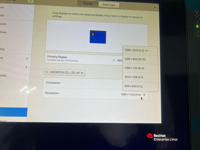

  1. We observe that we cannot see the login screen in primary display during booting( model: AXIOMTEK.CO.,LTD.19"). it is going to extended mode, where secondary monitor display from GPU is connected.
    After we login, we can see the primary display working fine again.
    any idea for this behaviour?
  2. Also, if we set the primary display to 1280*1024 in display manager settings in the GUI and reboot the unit, we are not able to see the login screen during the booting again.Any idea why?

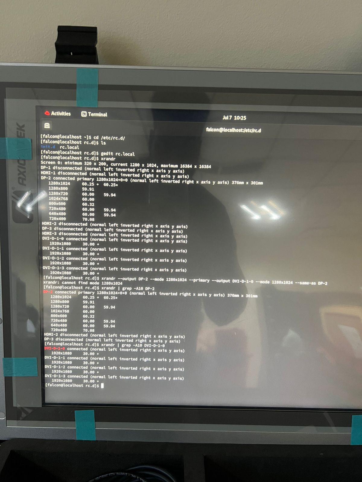

  3. Also, we observe that we can always see 4 SDIOUT displays shown as Connected with the XRANDR command, even though we have not connected any secondary monitors?
Please explain all these unknowns, so that we can clearly understand how this stuff works.
