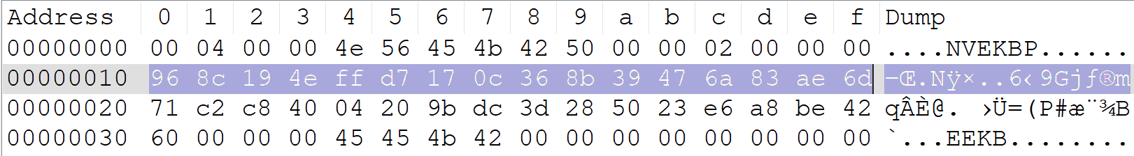

I’ve read the post you linked and digged into gen_ekb.py, but I didn’t found anything that could point to a reading of FV from (existing?) EKS image, so I made a test. After generating required keys, I called gen_ekb.py multiple times, and this is the contents of the generated eks_t234.img files:
After first call (higlighted is FV area):
After second call (without regenerating any key):
Then, I patched gen_ekb.py as follows:
After calling patched script:
So it seems to me that gen_ekb.py (from L4T36.4.4) is still in charge of FV generation.
What am I missing?
