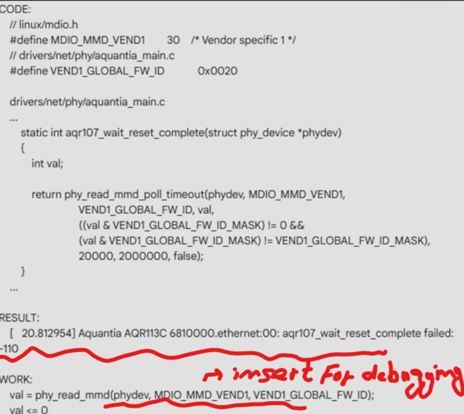

aqr107_wait_reset_complete only calls phy_read_mmd_poll_timeout. If the PHY didn’t give out any response, then it means this condition does not meet as mentioned in document.
  • Make sure that the PHY comes out of reset and is in a ready state (read the PHY ID by using mdio tool to ensure that the PHY firmware is successfully loaded) when the PHY reset GPIO is toggled.
I can read PHY ID: “31C3 1C12” through MDIO
I can’t read AQR Firmware ID accurately.
-------- Firmware ID is always read as 00, but since this value is incorrect, Error Return (-110)

What is the firmware ID got printed from your side now?
If the firmware ID is always a invalid one, it means the firmware is not yet loaded.
  1. Firmware ID Read as “00” always
    Checked by inserting debugging Message for Firmware ID Read
  2. Firmware Loading
    → FW loading H/W signal can be captured with Oscilloscope.
Hi, WayneWWW,
I can now Load EEPROM Firmware successfully.
The problem was that the EEPROM garbage data was not cleared and malfunctioned for reading Firmware ID from AQR Memory.
So, my behavior is to erase the Full EEPROM area and flash EEPROM (firmware) again and the orin CPU successfully can read the exact Firmware ID from AQR Memory.
