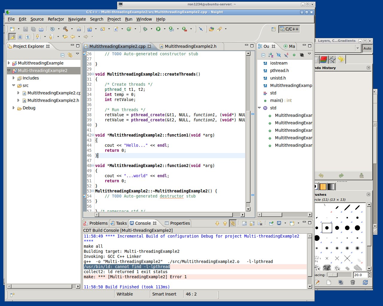

okay,
I fiddled around with the property setting on “nsight” and I was able to get to this point: see attachment
How to do I fix the link error?
Simply replace “-lpthread” with “pthread” on the “Libraries” property page.
thanks,
It works!
