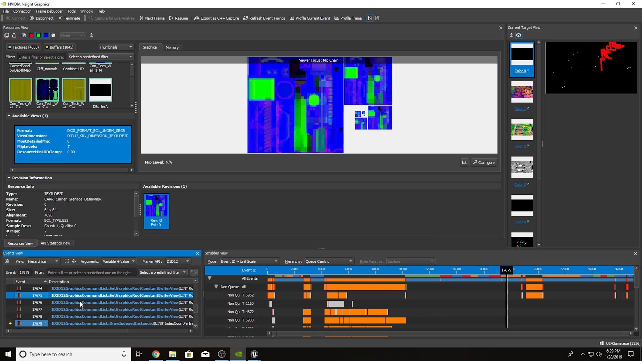

NVIDIA Nsight Graphics 2019.1 is now available for download! Version 2019.1 includes the following enhancements and bug fixes:
New Feature: Nsight Aftermath (Alpha)wer
  • Enables users to debug GPU crashes and hangs caused by their DirectX 12 applications
  • Provides an simple UI that directs users to the line of shader source code where the crash/hang occurred
  • New Feature: Trace Compare in GPU Trace
  • Enables side-by-side comparison of selected frames and traces
  • Users can align the timeline to specified events for better visual analysis
  • New Feature: Range Profiler selection linking
  • Range Profiler selection now sets the current event to the last event in the selected range
  • Enhances transition between profiling and debugging workflows
  • New Support: OpenGL and Vulkan Interoperability debugging
  • Enables the Frame Debugging activity for applications using OpenGL and Vulkan simultaneously
  • Supports EXT_external_objects
  • New Support: DirectX12 NVAPI Metacommand Support
  • Enables analysis of DirectX12 titles utilizing DLSS (Deep Learning Super Sampling)
  • Improved:
  • Better UI performance in Frame Debugging and Frame Profiling activities
  • Includes several other bug fixes and application compatibility fixes
