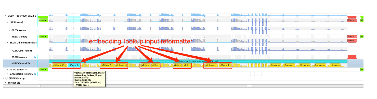

I think it works fine, but the diagram seems not quite readable. The first time I saw this software was from a TensorRT presentation given by Tencent. During the presentation they showed the entire running prcess like below:
 ![tencent](https://global.discourse-cdn.com/nvidia/original/3X/e/f/efda0ad68f6d7327696fbae041bdda3f35253dae.png)
which has blocks with labels on and telling what does each part did. I wonder if it is a hidden function that I didn’t use it correctly or it is achived by using external supports?

Okay, a few things.
You’ll need to zoom in, a lot. I recommend CTRL and the scroll wheel on your mouse as the most effective way to zoom in. When you scroll in, as there is enough space on-screen, the underlying kernels will become big enough to display text. You can also mouse over kernels to get information, but I find it clearer to just scroll a long way in. You are showing 8 seconds of time in your screen shot…there isn’t a time indicator on the one from the presentation, but I bet it is less.
You’ll need to open the process and find the GPU associated with the activity. Then open that GPU. The screen shot you are showing on the bottom is looking inside a particular CPU to see where the items that were annotated with NVTX are showing up.
(and of course, you will want to have NVTX trace turned on, which I assume you do, as it is usually on by default, but I can’t actually see from your screenshot if it is).
This run did not have NVTX, but you can see that I drilled down to ~16 ms of time, that information about the GPU activity (memory transfers) is starting to show up, and that mouse-overing reveals more information:
 ![image](https://global.discourse-cdn.com/nvidia/original/3X/3/1/31c15f64502c2d51867725b00816502b542e49d2.png)
Now the same thing, but I zoomed in again and you can see the actual working kernels and the mouseover text for same.
 ![image](https://global.discourse-cdn.com/nvidia/original/3X/a/0/a00fe0018b0ca5c257119621f98d4253b8697223.png)
