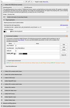

Nsight System Launch:
By UI:
Result:
No CUDA events collected. Does the process use CUDA?

for the CLI that’s a Nsight Compute command line.
I would expect you would have something like:
nsys profile -o profile python3 driver.py --job resnet50
Process-tree wide is on by default from the CLI

Are you forking w/o exec?
–trace-fork-before-exec
true, false
default - false
If true, trace any child process after fork and before they call one of the exec functions. Beware, tracing in this interval relies on undefined behavior and might cause your application to crash or deadlock. Note: This option is only available on Linux target platforms.
It also does not work.
