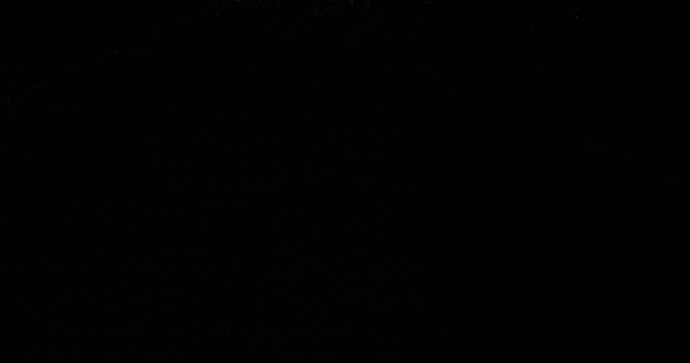

I have found some h264 files can not be decode by nv gst plugin normally on TX2.
When I try to decode the h264 file ,I will get some almost black pictures.
However the h264 file can be decoded well by using ffmpeg or gstreamer on x86 ubuntu16.04.
The problem can be reproduced on both R32.2.1 and R28.2.1
The gstreamer pipeline is :
gst-launch-1.0 filesrc location=1.h264 ! h264parse ! omxh264dec ! nvjpegenc ! multifilesink location=%04d.jpg

Please check and view the output pictures, 0011.jpg ~ 0047.jpg are abnormal pictures on my TX2.
yes, I can confirm the issue at my device;
0011.jpg → 0.047jpg are black;
0001->0010 & 0048->0150 shows road images
the video duration is 0:00:06.051384496

I don’t understand the root cause, but in my case decoding your file on host with avdec_h264 or with ffmeg does produce same black images.
On the other hand, both do work on my Xavier.
I see different versions of used libs, so I guess a bug has been fixed or a new feature got supported.
BTW, the following pipelines with hw h264 decoding work for me:
gst-launch-1.0 -v filesrc location=1.h264 ! h264parse ! nvv4l2decoder ! nvvidconv ! jpegenc ! multifilesink location=%04d.jpg
gst-launch-1.0 -v filesrc location=1.h264 ! h264parse ! nvv4l2decoder ! nvvidconv ! 'video/x-raw(memory:NVMM), format=I420' ! nvjpegenc ! multifilesink location=%04d.jpg
