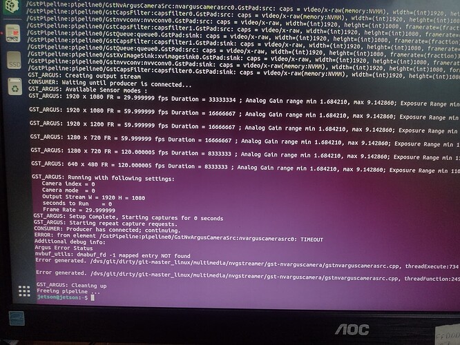

Trying to stream AR0234 sensor with serdes and AGX Orin with Jetpack 6.0, but getting NVARGUSCAMERASRC0 error.
However, recently we are facing the following issue while streaming:
  1. The setup mentioned above can stream only for the first time with a gst-launch command or python script with GStreamer pipeline and OpenCV. Once we discontinue with the capturing of the stream and try to recapture the stream for second time, the streaming is not enabled, the frames are not captured and the display BLACK OUTS.
  2. Once we power off the serdes as well as AGX Orin kit and run the gst-launch or python script for the first time after power on, the streaming is successfully. Again, if we close the stream and try to recapture the stream for second time, streaming fails.
Kindly help us trouble shoot this issue. Streaming should be continuous irrespective of number of attempts.
Attached herewith is the error log for your reference:

I would suspect the serdes didn’t reset well cause the problem.
Is there any means apart from serdes shut down to reset it?
It’s better to reset by power down/reset pins.
Check with HW if any power/reset pins.
Thats what we tried exactly, power down the device. But every time it’s not feasible to power down and boot the device again. So, we are looking for an alternative solution.
What’s I mean is the power/reset pin for the serdes it could be a GPIO or power gate instead of AGX.
I’m also facing the same issue, I’m unable to reset the SerDes card as their is no pin/button for reset.
