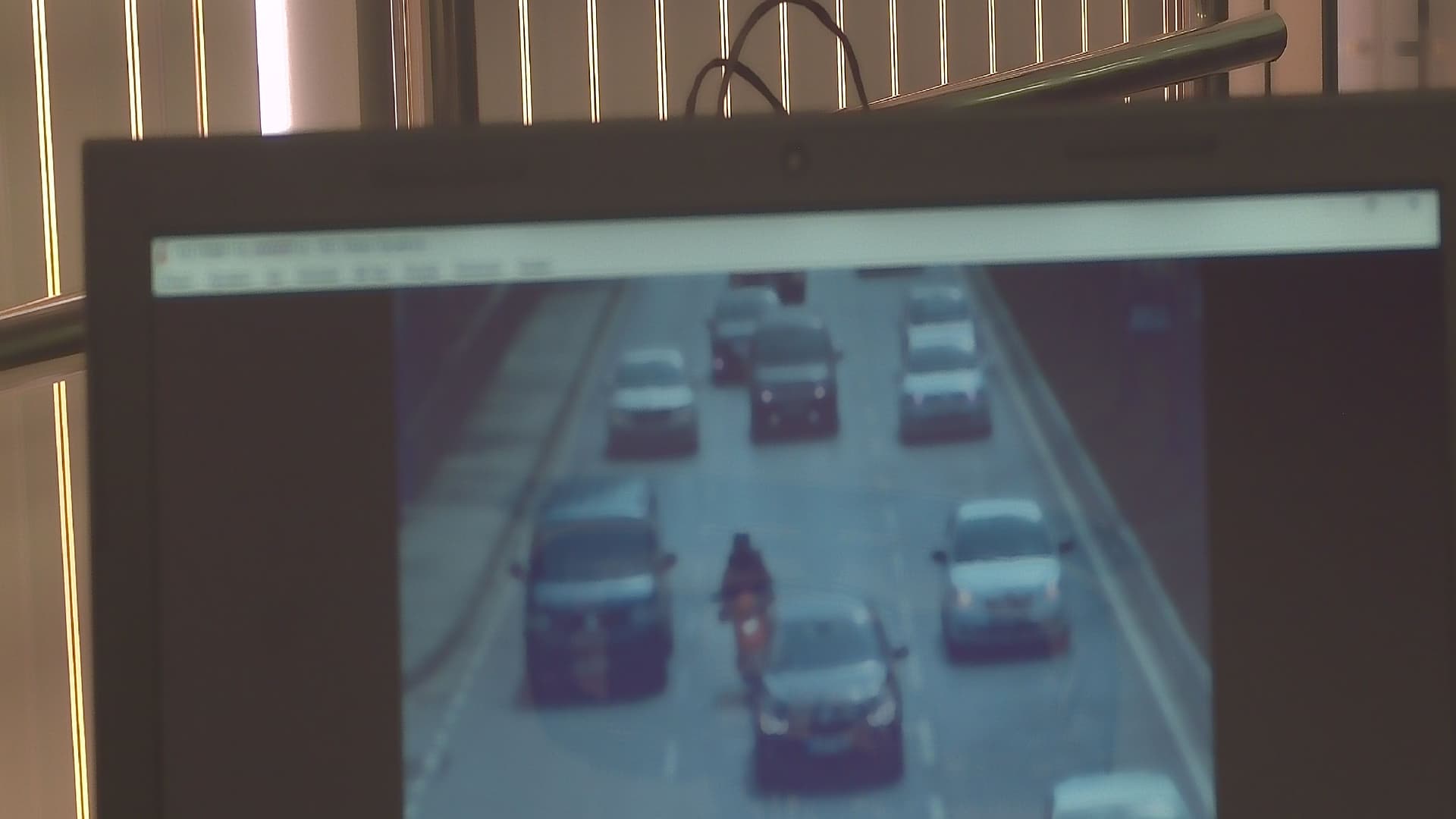

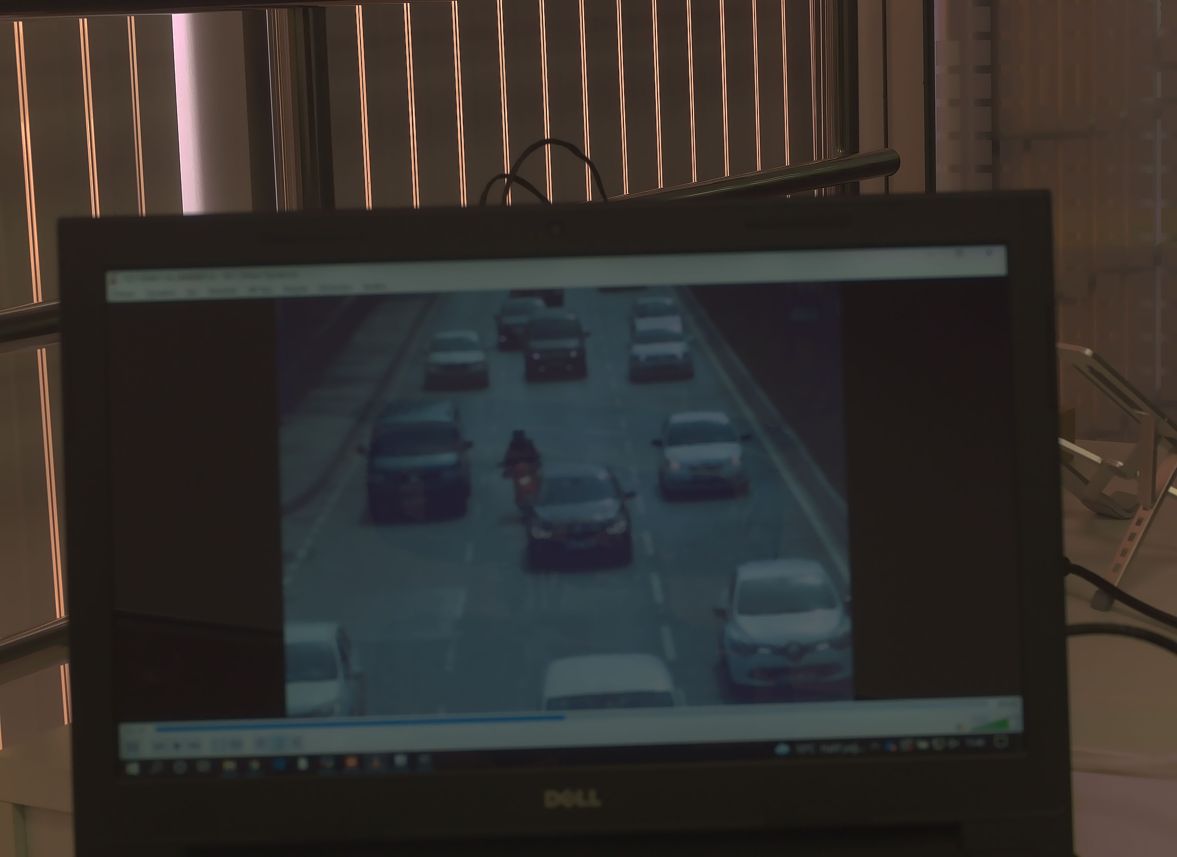

I added crop_resize and crop .At first try it works correct but second try it is corrupted and all following transformations are corrupted.
Original image size is 4128 x 3008
I want to crop image From left 0 top 500 w 3840 h 2160
I want to resized cropped image From left 0 top 500 w 3840 h 2160 to 640x480
14_crop
14_crop_resize
14_crop_resize
14_org
767_crop
767_crop_resize
767_crop_resize
767_org

Please allocate the buffer in NvBufferLayout_Pitch. And for debugging, you can call dump_dmabuf() to dump the YUV data and check if it is correct.
Hi Danelll,
NvBufferLayout_Pitch solved my problem,both resize and crop worked, thank you for your help.
