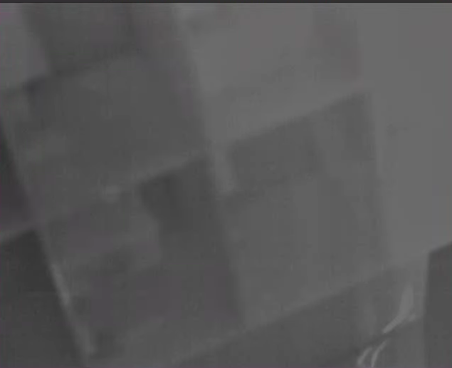

found working example there
but have strange problem when try to copy data from usb cam to NvBufSurface with color format NVBUF_COLOR_FORMAT_UYVY and than converted to NVBUF_COLOR_FORMAT_RGBA
NvBufSurf::NvCommonTransformParams transformParams = {0};
transformParams.flag = NVBUFSURF_TRANSFORM_FILTER;
transformParams.filter = NvBufSurfTransformInter_Algo3;
auto res = NvBufSurf::NvTransform(&transformParams, fd, fd2);
after dumping buffers (raw, UYVY surface and RGBA surface) I see that all 3 files has same format and size
when I try add flip into my transform last one become flipped but also same size and format
transformParams.flag = (NvBufSurfTransform_Transform_Flag)(NVBUFSURF_TRANSFORM_FILTER | NVBUFSURF_TRANSFORM_FLIP);
transformParams.filter = NvBufSurfTransformInter_Default;
transformParams.flip = NvBufSurfTransform_Rotate180;
also when I try change “output“ buffer format to NV12 nothing changed - same format after conversion
*surf2 - after conversion to GBA and flip
*surf. - after copy data from cam to UYVY surface
The supported conversions are demonstrated in
/usr/src/jetson_multimedia_api/samples/07_video_convert/
Please refer to the sample for your implementation.
