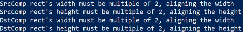

Hi everybody,
I am wondering how to set an odd value to the pad properties of xpos, ypos, width and height. What is the reason for this behavior?
The following screenshot shows the messages, which are output if the pad properties width & height are set to an odd value:
This is the GStreamer Pipeline that created the above messages:
sudo gst-launch-1.0 -e -v nvcompositor background=0 name=comp sink_0::xpos=0 sink_0::ypos=0 sink_0::width=1921 sink_0::height=1081 ! nvdrmvideosink set-mode=1 color-range=1 videotestsrc ! 'video/x-raw, format=(string)RGBA, width=(int)1921, height=(int)1081' ! nvvidconv ! 'video/x-raw(memory:NVMM)' ! comp.
