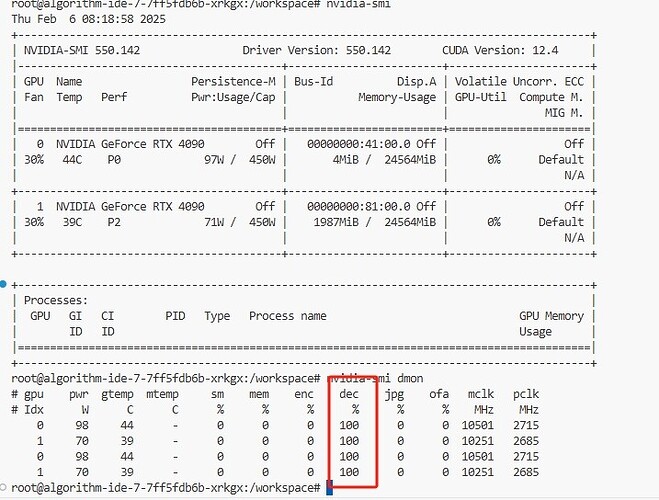

hello,
I use nvcr.io/nvidia/deepstream:6.3-gc-triton-devel docker image create continer. Sometimes it work well with deepstream-app, but I execute " gst-launch-1.0 uridecodebin uri=file:///opt/nvidia/deepstream/deepstream/samples/streams/sample_720p.mp4 ! fakesink " stuck recently.
then I kill process, but gpu decoder still reaches 100%. NVDEC resouce cannot release, how to solve this issus, os is centos.
Could you try that with our latest version DeepStream 7.1?
my applications already running for a longe time in customer, it cannot upgrade. I reproduce it today with gdb run my application, thread multiqueue3:src recv seg signal, backtrace only show libnvcuvid.so.1。Is there way release nvdec?
In theory, the following software is compatible with DeepStream 6.3. dgpu-setup-for-ubuntu
CUDA 12.1  Driver R525.125.06
The exceptions may occur when versions are incompatible. We recommend that you first adapt the version according to our Guide, and then see if there is still this problem.
