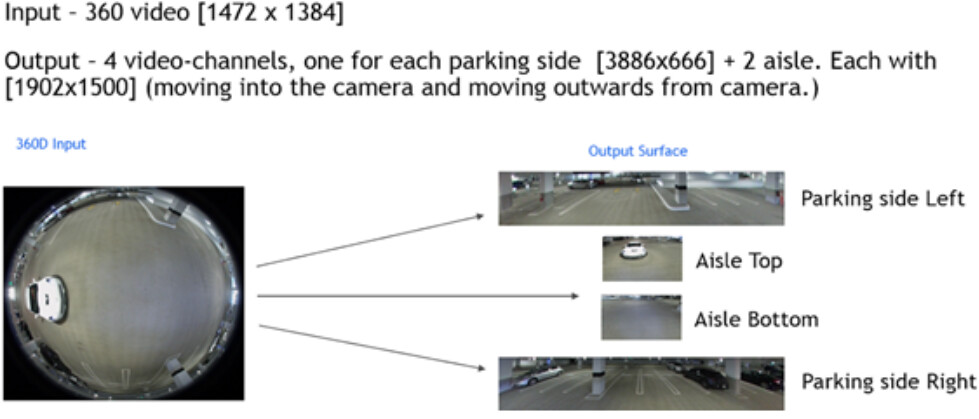

In the deepstream-dewarper-test, we divide the 360 image into 4 region as shown below:
 ![image](https://global.discourse-cdn.com/nvidia/original/3X/4/d/4df14c964d31189ef6ca9e92e02a32edd8d06d54.jpeg)
 ![image](https://global.discourse-cdn.com/nvidia/original/3X/b/3/b3fd77e9b5ea03ebbc8b40f5b847171d3b3c90f7.jpeg)
Is it possible dewarp it into just 1 panaromic image?

In deepstream-dewarper-test, in config\_dewarper.txt, set only [surface0] section, remove [surface1/2/3] groups. Set [surface0] parameters as per the need. Also disable aisle-calibration-file=csv\_files/nvaisle\_2M.csv and spot-calibration-file=csv\_files/nvspot\_2M.csv from config file as these are for 4 surfaces
In addition, please try to use the latest DS5.1 version if possible.

@bcao Can you provide some more in-depth explanation of the parameters? I was able to dewarp the image with trial-and-error but I can’t fix the orientation. Now I would like to rotate it to get panaromic image.
 ![Screenshot from 2021-03-15 17-27-49](https://global.discourse-cdn.com/nvidia/original/3X/9/c/9c6b8db23fbf50bf3a3d1f2765b54adec6efb937.jpeg) ![Screenshot from 2021-03-15 17-30-00](https://global.discourse-cdn.com/nvidia/original/3X/2/5/251a121f3bb95f3840f6773b64673646edc6f3a1.jpeg)
My surface config:
> [surface0]
> projection-type=2
> surface-index=0
> width=1000
> height=1500
> top-angle=-180
> bottom-angle=180
> pitch=90
> yaw=0
> roll=90
> focal-length=318
