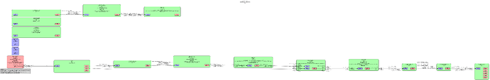

I have 4 different rtsp sources and this is my pipeline
I am using nvdsmetamux to merge meta data from pgie’s. There are 2 sink pads at metamux sink_0 and sink_1. sink_0 is for detection pgie and sink_1 for pose estimation pgie. if i set active_pad=sink_0 the meta data from src1 and src2 will go to fakesink ( i checked that with probe function) and meta data of src3 and src4 will be lost. if I set active_pad=sink_1 then data from src3 and src4 will go to fakesink and meta data of src1 and src2 will be lost.

I think this is normal. The source id of each nvstreammux is independent, which means that the source ids of the two nvstreammux in the above pipeline are both 0/1, which cannot be distinguished when merging.
So if you want to merge metadata from multiple branches, you can only refer to the pipeline of the parallel sample app. First, use nvstreammux to form all streams into a batch, then nvstreamdemux, nvstreammux, and finally merge them using metamux.

Gstreamer pipeline is similar to deepstream parallel inference app but its not working. pipeline does not send data down the pipleline however
when I remove 1 branch in middle from tee src_2 its started to send data down the pipeline.

So I updated the sample app test_app_3 and attached the code below so that you can reproduce the issue at your end.
So Issues I am facing with current pipline are these
if inveglglessink is in pipline data does not flow down the pipeline so when you replace it with fakesink data start to go down the pipeline but meta data for one of the source is empty as you will be able to see through probe function attached at src pad of metamux plugin.

Modify config_metamux.txt as follows
[property]
enable=1
# sink pad name which data will be pass to src pad.
active-pad=sink_0
# default pts-tolerance is 60 ms.
# pts-tolerance=60000
[user-configs]
[group-0]
# src-ids-model-<model unique ID>=<source ids>
# mux all source if don't set it.
src-ids-model-1=0
src-ids-model-2=1
# src-ids-model-1=0;1
# src-ids-model-2=1;0
# src-ids-model-3=1;2
Modify the pipeline as follows

Run the application
python3 deepstream_test_3.py -i file:///opt/nvidia/deepstream/deepstream/samples/streams/sample_1080p_h264.mp4 file:///opt/nvidia/deepstream/deepstream/samples/streams/sample_1080p_h264.mp4
In fact, the above program is equivalent to the following command line
gst-launch-1.0 uridecodebin uri=file:///opt/nvidia/deepstream/deepstream/samples/streams/sample_walk.mov ! mux.sink_0 \
               uridecodebin uri=file:///opt/nvidia/deepstream/deepstream/samples/streams/sample_1080p_h264.mp4 ! mux.sink_1 \
               nvstreammux name=mux gpu-id=0 batch-size=2 width=1920 height=1080 ! queue ! tee name=t \
               t.src_0 ! queue ! meta.sink_0 \
               t.src_1 ! queue ! nvstreamdemux name=demux per-stream-eos=true  \
               demux.src_0 ! queue ! tee name=b0_t \
               demux.src_1 ! queue ! tee name=b1_t \
               b0_t.src_0 ! queue ! b0_m.sink_0 nvstreammux name=b0_m batch-size=1 width=1920 height=1080 ! queue ! nvinfer batch-size=1 config-file-path=/opt/nvidia/deepstream/deepstream/sources/deepstream_python_apps/apps/meta-mux-test/dstest3_pgie_config.txt ! queue ! meta.sink_1 \
               b1_t.src_0 ! queue ! b1_m.sink_1 nvstreammux name=b1_m batch-size=1 width=1920 height=1080 ! queue ! nvinfer batch-size=1 config-file-path=/opt/nvidia/deepstream/deepstream/sources/deepstream_python_apps/apps/meta-mux-test/dstest3_pgie_2_config.txt ! queue ! meta.sink_2 \
               nvdsmetamux name=meta config-file=/opt/nvidia/deepstream/deepstream/sources/deepstream_python_apps/apps/meta-mux-test/config_metamux.txt ! queue ! nvmultistreamtiler width=1920 height=1080 ! queue ! nvvideoconvert ! nvdsosd ! nv3dsink
For DS-7.1, please refer to this repository, This is different from the previous
Hi Junshengy,
Above code is working for two streams but when i updated the code and added the 3rd stream only first stream (stream 0) works other two streams hangs.
issue
Modified config_metamux.txt:

    meta_mux_sink_pad_1 = meta_mux.request_pad_simple("sink_1")
    meta_mux_sink_pad_2 = meta_mux.request_pad_simple("sink_2")
    pgie_src_pad.link(meta_mux_sink_pad_1)
    second_pgie_src_pad.link(meta_mux_sink_pad_2)

Pipeline:
Please refer to the command line below to build the pipeline, Ensure that the pipeline of the Python code is consistent with it.
gst-launch-1.0 uridecodebin uri=file:///opt/nvidia/deepstream/deepstream/samples/streams/sample_1080p_h264.mp4 ! mux.sink_0 \
               uridecodebin uri=file:///opt/nvidia/deepstream/deepstream/samples/streams/sample_1080p_h264.mp4 ! mux.sink_2 \
               nvstreammux name=mux gpu-id=0 batch-size=3 width=1920 height=1080 ! queue ! tee name=t \
               demux.src_2 ! queue ! tee name=b2_t \
               b1_t.src_0 ! queue ! b1_m.sink_1 b2_t.src_0 ! queue ! b1_m.sink_2 nvstreammux name=b1_m batch-size=2 width=1920 height=1080 ! queue ! nvinfer batch-size=1 config-file-path=/opt/nvidia/deepstream/deepstream/sources/deepstream_python_apps/apps/meta-mux-test/dstest3_pgie_2_config.txt ! queue ! meta.sink_2 \
               nvdsmetamux name=meta config-file=/opt/nvidia/deepstream/deepstream/sources/deepstream_python_apps/apps/meta-mux-test/config_metamux.txt ! queue ! nvmultistreamtiler width=1920 height=1080 ! queue ! nvvideoconvert ! nvdsosd ! nveglglessink
Try to modify the batch-size property of streammux in branch1
