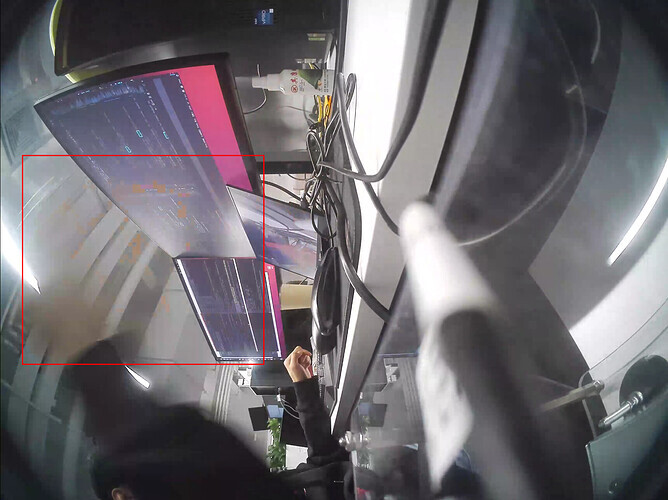

Using r38_2_add_nvvideoencoder.zip for H.264 encoding and saving the encoded result, some ghosting can be seen on the screen during playback.
My code modifications to r38_2_add_nvvideoencoder.zip are as follows:
patch_and_h264output.zip (12.9 MB)
Our camera data format is YUV422 UYVY
This issue can also be reproduced when using 01_video_encode.
You can also try using 01_video_encode to test it.

With the same yuv420m data, we can see that Orin performs better than Thor.
Orin
(Package: nvidia-jetpack
Source: nvidia-jetpack (6.0)
Version: 6.0+b106):
Thor:
See attached video:
for_nv_1103.zip (20.1 MB)

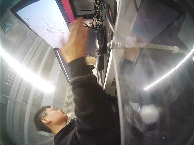

Please try modify ctx->enc->setBitrate(4<<20) < 0 to ctx->enc->setBitrate(12<<20) < 0, and setRateControlMode(V4L2_MPEG_VIDEO_BITRATE_MODE_CBR).
Please rerun and let us know the result.
Increasing the bitrate is helpful, but it shouldn’t be the solution, right?
You can see that the size of H.264 also increases after encoding.
setBitrate(12<<20):
setBitrate(16<<20):
setBitrate(20<<20):
setBitrate(24<<20):
Increasing the bitrate is a solution to address the ghosting issue, as it enhances image clarity and reduces motion artifacts.
The question is that compared to ORIN, the same bitrate (4 << 20) doesn’t show any particularly noticeable motion artifacts. Is this a rollback issue?
Increasing the bitrate has negative effects on performance and compression ratio; we still hope to find a better solution.
