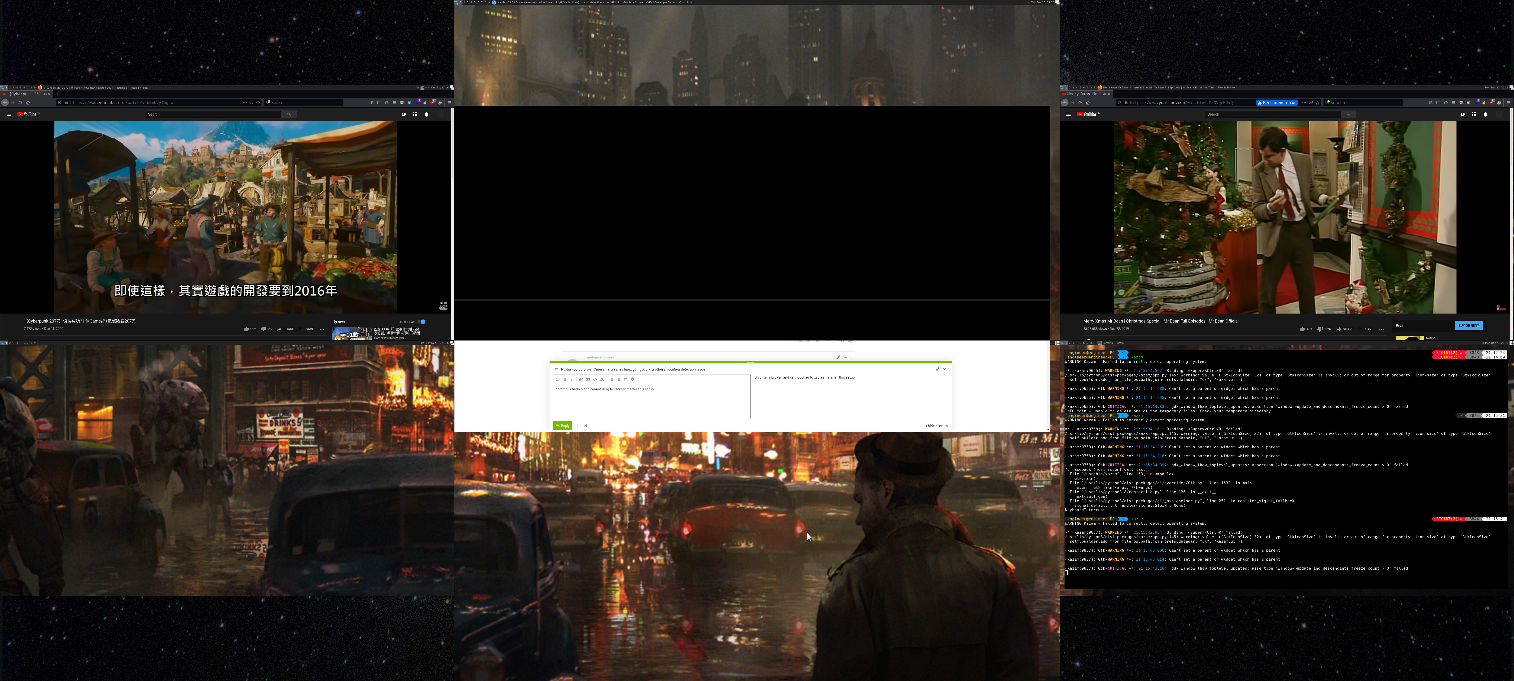

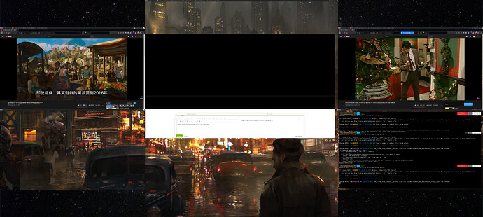

  • Firefox drag & drop crashes entirely, need to force restart

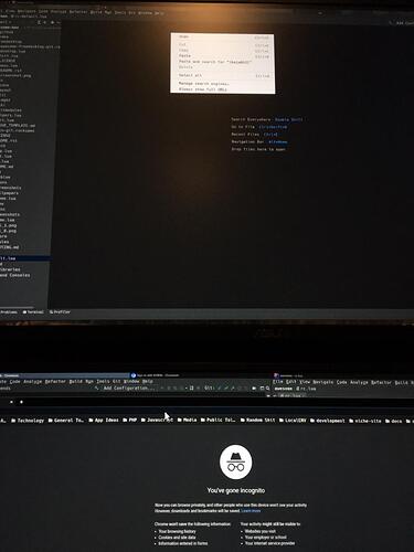

  • Chromium right click menu jumped wrongly

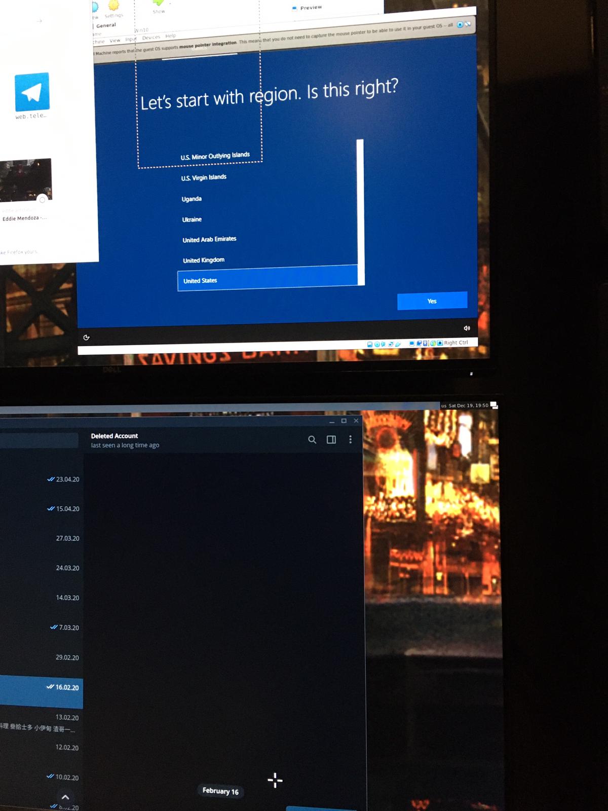

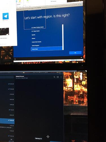

  • Telegram cant select file to upload

Drag & Drop Firefox tab bar=> crashes

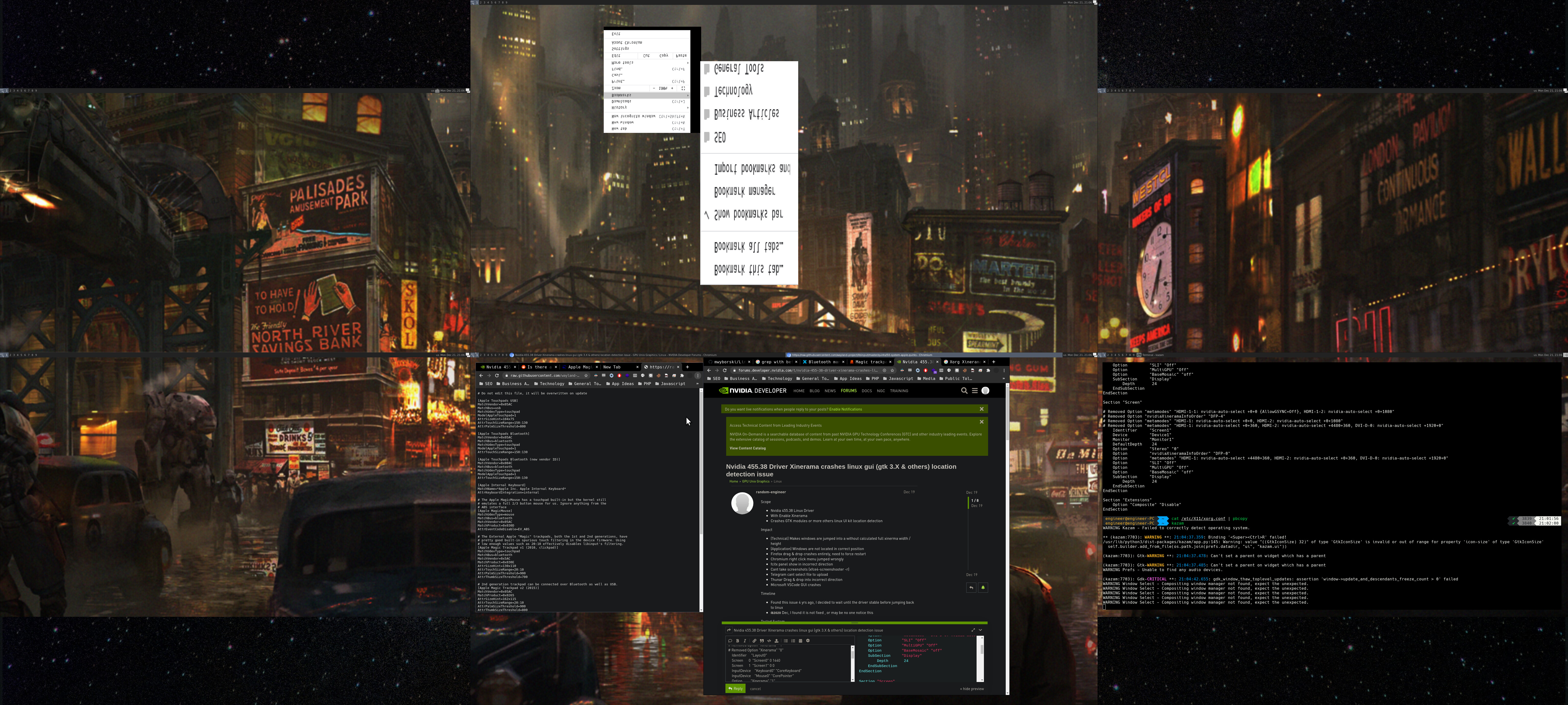

Chromium right click menu jumped wrongly (Partialy Fixed, the drop down menu crashed in reverse UI

The Chrome menu UI is completely broken after disable the composite.
chrome is broken and cannot drag to xscreen 2 after this setup.
