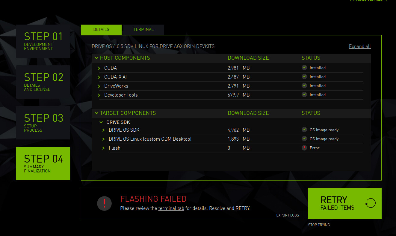

Nvidia Drive Orin Flashing issues
During the flashing process of the Orin AGX following error occurs:
driveinstaller.log (620.9 KB)
All other components are installed well.
I tried out different USB cables/ USB ports and the Orin AGX is in recover mode.
What could be the reason?

Dear @markus.schratter,
Could you share ~/.nvsdkm/ folder as zip file? Also, May I know the previously installed DRIVE OS and working status of the board?
saw the message from your log. Please review System Requirements and make sure you have enough free disk space.
[2023-01-10 09:27:17,083 root DEBUG console_logger.py 17 7208] b"command line used was:\r\n[‘/home/nvidia/nvidia/nvidia_sdk/DRIVE_OS_6.0.5_SDK_Linux_DRIVE_AGX_ORIN_DEVKITS/DRIVEOS/drive-foundation//tools/flashtools/bootburn/bootburn.py’, ‘-b’, ‘p3710-10-s05’, ‘-B’, ‘qspi’, ‘-x’, ‘/dev/ttyACM1’, ‘-D’]\r\n\r\n\r\n\x1b[01;31ms_ERROR_INSUFFICIENT_DISK_SPACE\r\nBootburn requires 17,985,353,161 bytes to proceed with image generation but free available space in host is 11,791,831,040\r\nFree some space and try again!\x1b[0m\r\n\r\n\r\n\x1b[01;31mException caught in bootburn \x1b[0m\r\n"
@VickNV Thanks, the storage issue was the problem.
