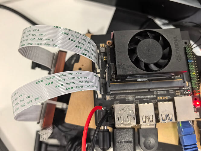

I’m using a Jetson NX to simultaneously read from the IMX477 cameras on CAM0 and CAM1. The program runs normally at first, but after some time, an error occurs.
I’d like to know what factors are related to this error — whether it’s caused by the current supplied by the onboard power source or by an issue with the camera driver. If it’s a driver problem, then why did it initially run without any errors?
The following error is output.

hello wxc_xc,
may I double check which Jetpack public release version you’re working with?
besides.. please check you could recover this by restarting Argus daemon service.
for instance,
$ sudo pkill nvargus-daemon
$ sudo systemctl start nvargus-daemon
I’m using JetPack 5.1.4. Running the command sudo systemctl restart nvargus-daemon can restore normal operation, but this issue causes the detection program to be interrupted, which is very annoying. Is there any effective solution to prevent this problem?
hello wxc_xc,
please see-also Topic 316367 to apply the pre-built update for Argus stability fixes.
