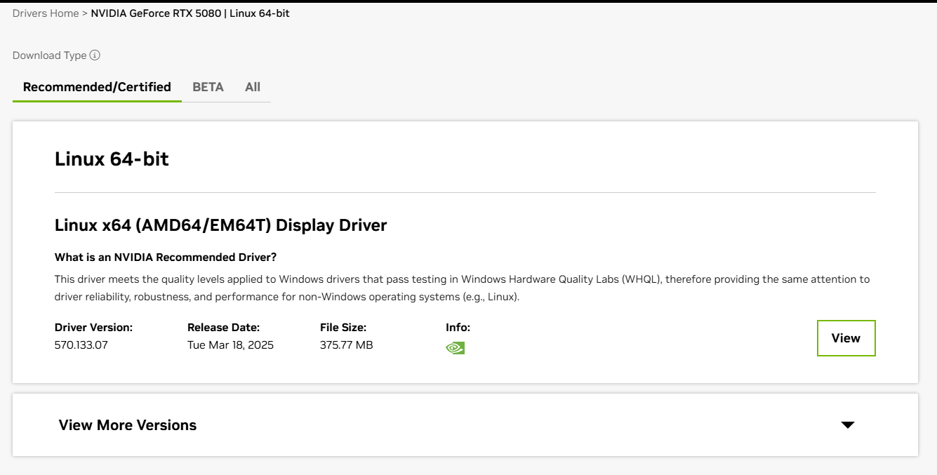

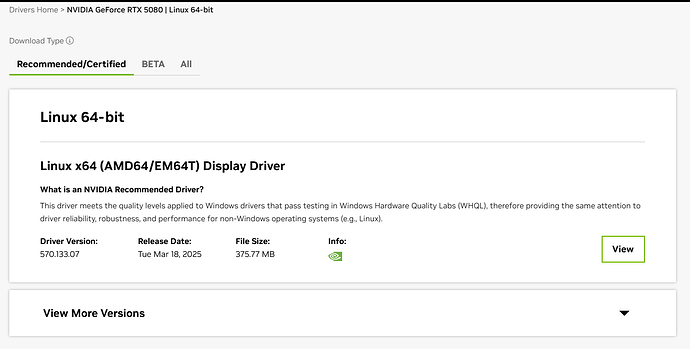

I installed sudo apt install nvidia-driver-570, but it installed version 570.124.06.
How about changing it to 570.133.07? I found on the NVIDIA website that the RTX 5080 is compatible with version 570.133.07
If you click “Vie More Versions” you would also see the 124 version, no worries.
