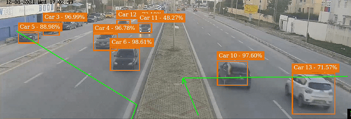

I’m using the Dsexample plugin in my pipeline, and most of the time bounding boxes get rendred as such:
When I restart the application there is a chance that they get rendred normally but it’s like a coin flip. Is there anyway I can fix this problem?

Can you share the picture when it is normal?
Yes, this is is how it’s supposed to look:
Do you set any background color for the object?
Yes I’m setting the background color as orange, this is how I change the colors of the bounding boxes:
